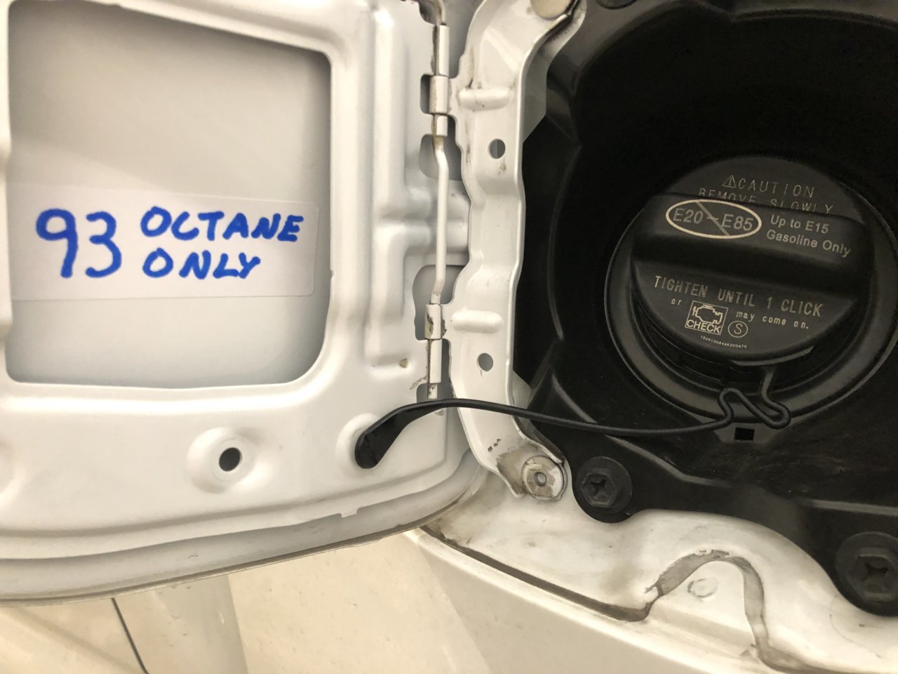

    I run 93 base because 93 is relatively cheap where I live. I tested 91 and 93 tunes and prefer 93. I put a note by my gas cap just in case anyone else is driving/filling my truck. 0FA70DD7-D0AC-4B67-96CC-181839D60685.jpg
