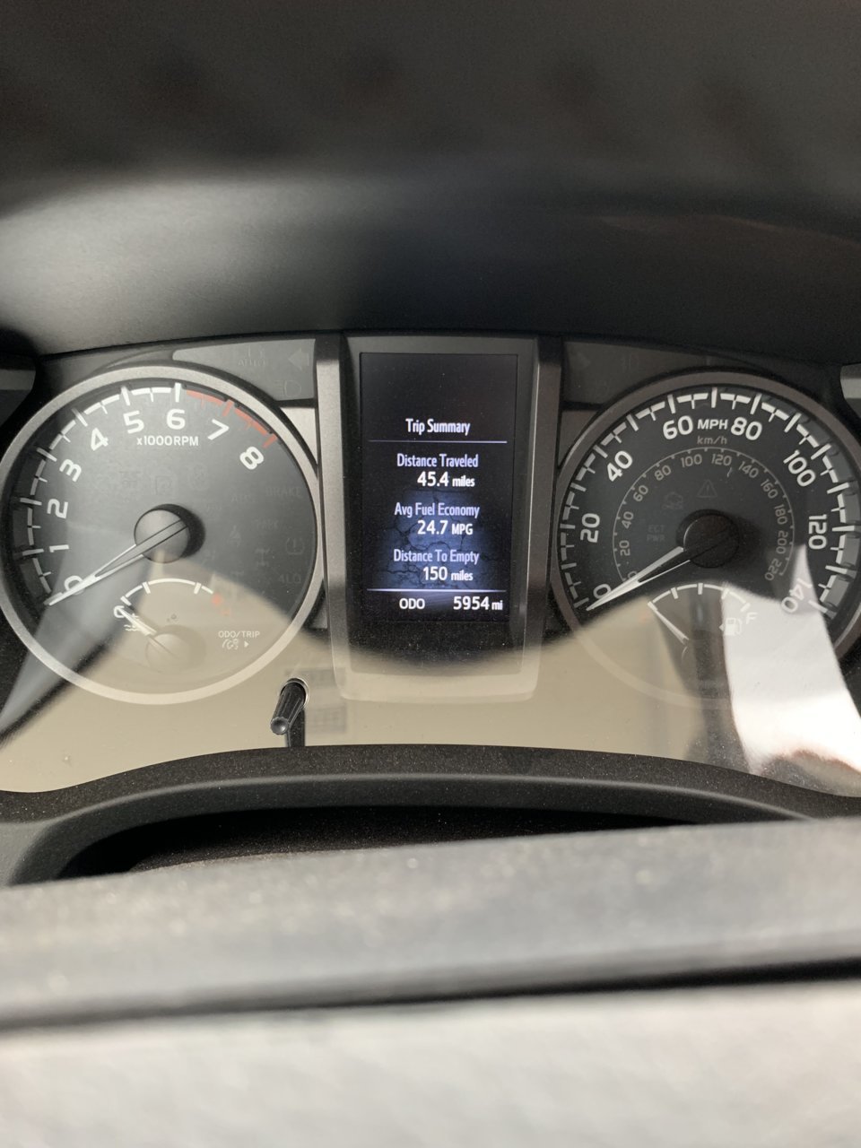

  13. May 29, 2019 at 8:58 AM
    rainyben45
    rainyben45 Well-Known Member
    Oct 19, 2016
    #200169
    323
    Ben
    Ventura County
    2018 TRD OR DCSB 4x4
    543EFCB9-6E01-48AF-8877-C8AC1ED2D212.jpg On 91 base with ECT engaged most of the time. Fully loaded w/ camping gear and camper shell. Stock height/tires. I’m liking ect +91 base a lot! Holds gears and shifts like butter and has all the power I need.
    BOMBS and TRDOBSESSED like this.

    Do you use ECT when your not loaded with your camping gear?

    No not really
