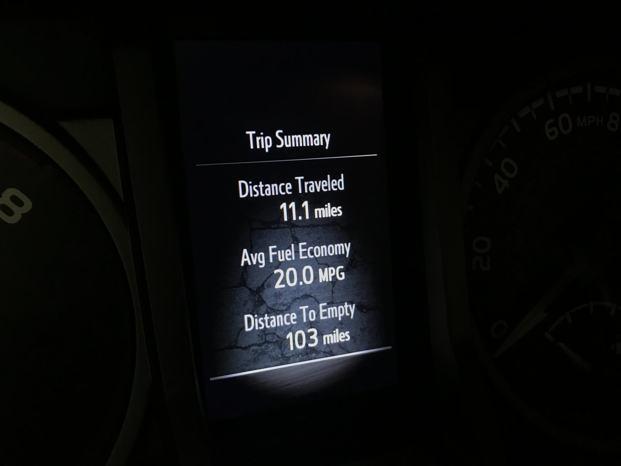

  6. Sep 13, 2017 at 8:50 AM
    #4486
    dYL0n
    dYL0n أنا لست الإسلامي
    Jan 14, 2011
    #49250
    4,595
    Dyl0n
    New Orleans, LA
    17TRDORDCSBQSJBLKBRO2SPECU1.04
    1.04. Kbro2s. ICONS.
    To go on with this post. I just ran home from work for lunch and got 20.0 MPG
    dskakie, Reypac24, 17TRDOR and 2 others like this.
