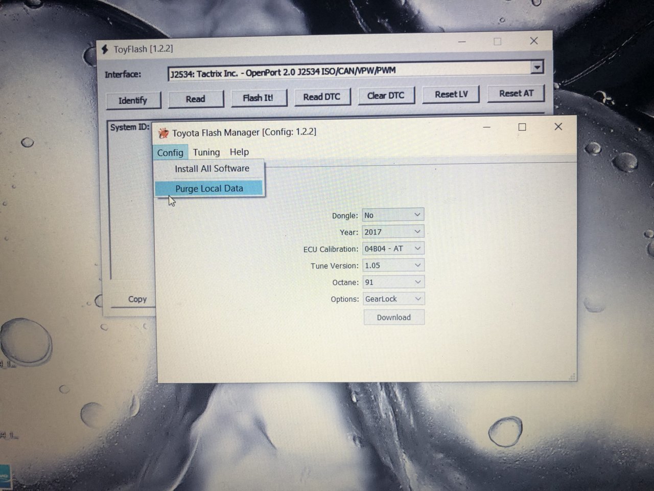

    Yeah I still have a pretty good wifi connection sitting in my driveway.
    I can identify successfully. I don't see an option to reset the LV or AT though. That is actually what I wanted to try to begin with but I don't see an option to reset those.

    Did you update software?

    Have you updated FM

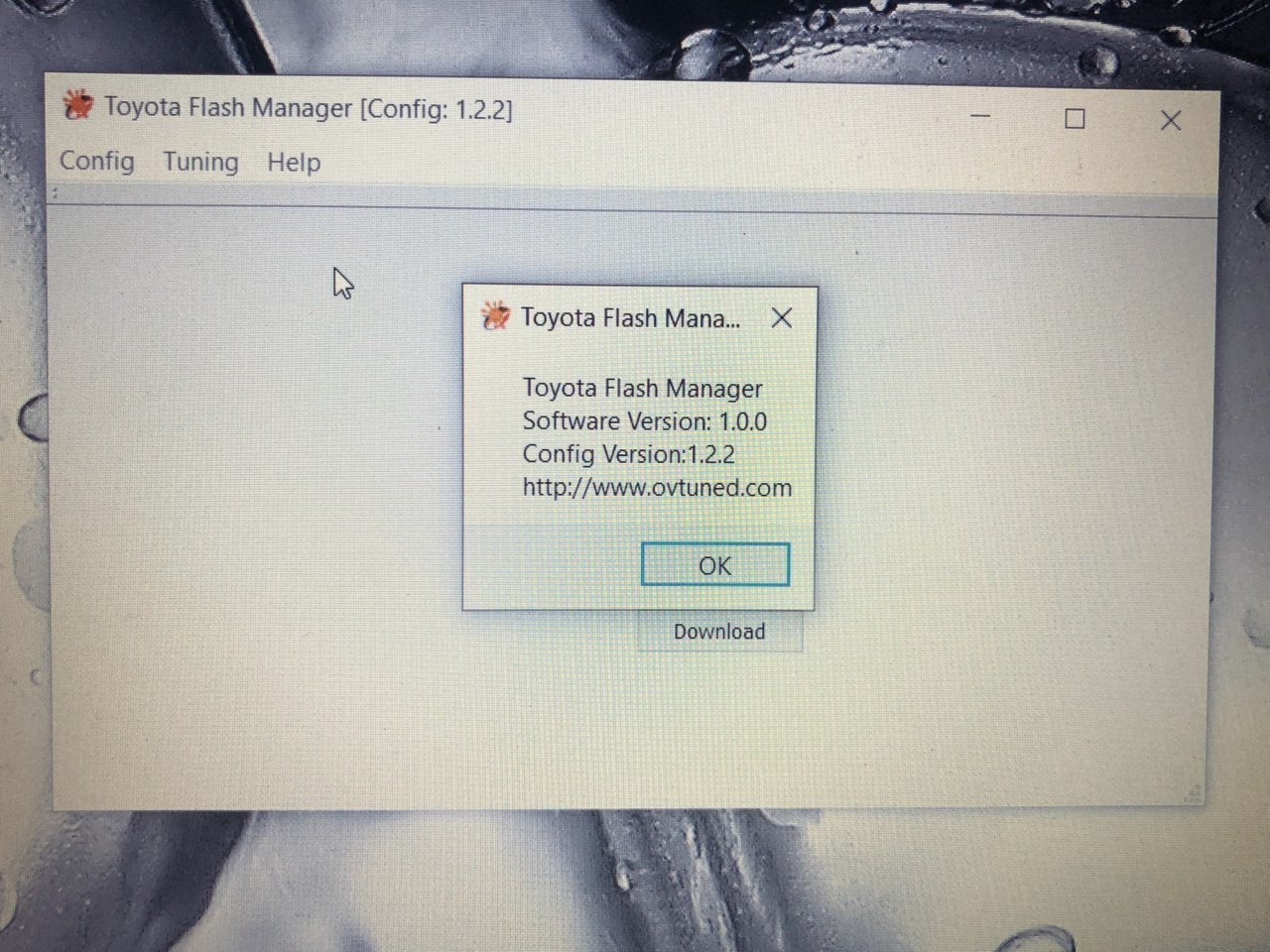

    Yeah I've clicked Update in the FM software and it says it's up to date. I feel like it's maybe not actually updating though. It says the software version is 1.0.4 and the config version is 1.2.2.

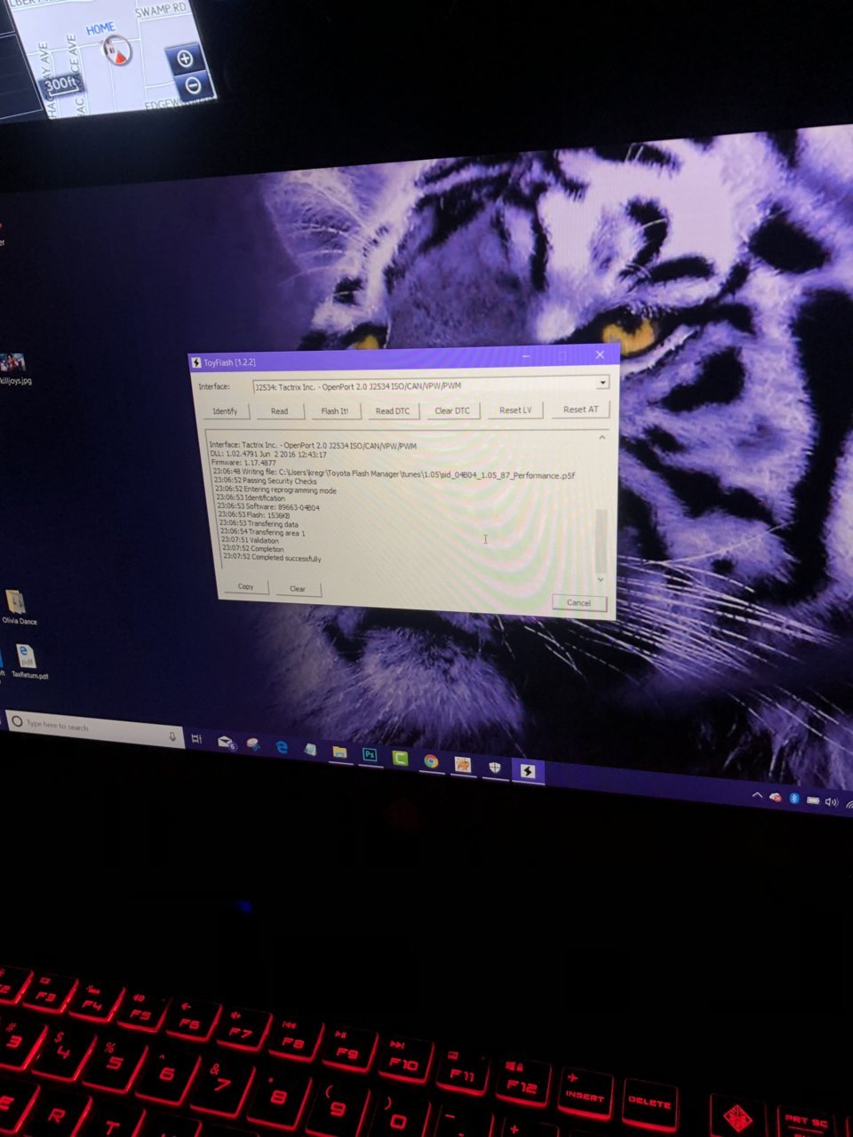

    I guess my software is older than yours. I just flashed earlier today from 1.05.1 back to 1.05 performance 91 and it worked.

    Did you click config then install all software?

    I just looked over the instructions again and it looks like I missed the purge local data and install all software steps. I just did that and it actually opens the P5Flash app now, so I think that may have been the key. I'll go try to flash the truck now...

    Just went out to garage and reflashed 1.05 87 perf, no problems. Took 2 mins., software is working!
    Not sure what’s going on with yours, but we’ll figure it out!

    Just flashed successfully after getting the software updated correctly. Purging the local data was the step I missed previously. Thank you very much for the help!
