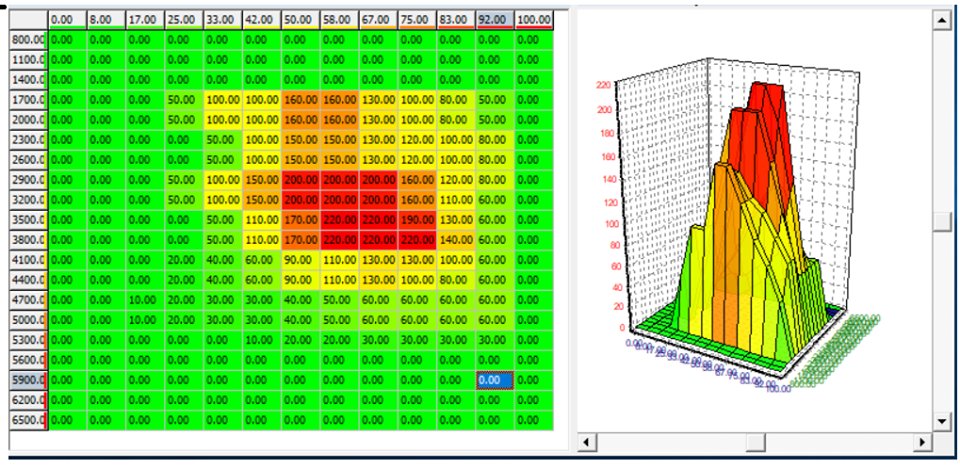

    Rather than independently custom tuning every single shift table for different trucks, we have developed a 3D compensation map for shift tables that take engine speed and accelerator position into account, and modifies shift limits based on this.
    So we can tune 1 3D table instead of an endless amount of shift tables.
