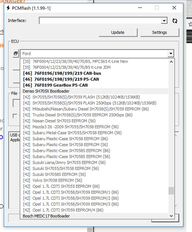

    Okay dongle dudes. How the hell do you do this? I have the file downloaded. Everything ready to go. What do I do with these three files? Install all of them? One of them? It's been a while since I've done this. Also at the top there is no interface to choose from. Does that matter? All I could find in the FAQ was dongless fellows. Which I am not. :D
    Edit: Resized way too big image.

    You only need one file. You can select either of the top 2 - p5 can or can bus
