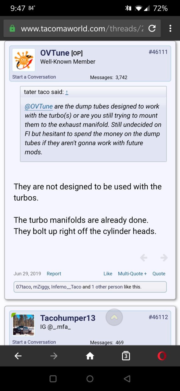

    i haven't read all this mess and there's no issue. i just saw a couple clear mentions here is one..

    Read the turbo thread. They can be used with turbos or SC.

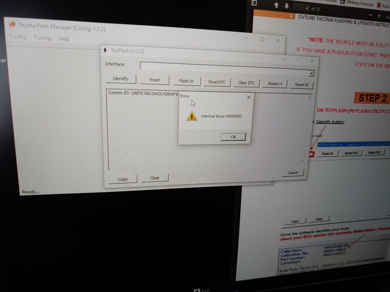

    I can't find my ECU code or identify my system?

    Now the menu item "p5flash utility" is grey and unavailable?
    Wtf is a dongle?
    Who wrote these instructions?

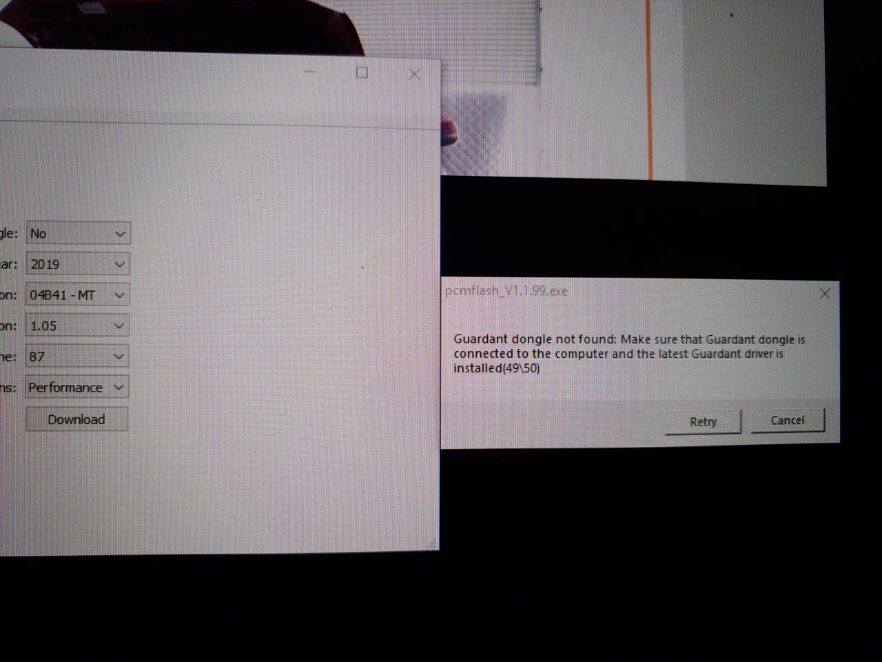

    Wtf is a "guardiant dongle"???

    The old tuning kits came with dongles and use the PCMFlash utility. The newer kits don’t have dongles and use the P5flash utility.

    "FOR DONGLE USERS - (If your kit came with a mini black USB or Purple USB Flash drive) Plug your USB drive into your computer and use the PCMFLASH utility for flashing, NOT the P5Flash utility."
    Dongle preceded the now current Tactrix OBDII cable. Assuming you have the new cable. Follow the instructions above and available online.
    From your screenshot it appears you using PCMFlash. It is looking for the associated device (old dongle) to communicate. Use P5Flash.
    It might be a good idea to re-read the instructions. Just a suggestion.

    P5Flash gave me an error code.
    I restarted the laptop and P5Flash was then unavailable and greyed-out.

    I HAVE FLASH MANAGER DOWNLOADED, INSTALLED ALL SOFTWARE BUT THE FLASH UTILITY WILL NOT SHOW?
    Normally this happens from Anti-viruses and windows defender blocking and deleting our software. You must either set an exception or disable your anti virus. (our software is virus free)
    MY SYSTEM ID HAS CHANGED OR MY FLASH MANAGER - FLASHING SOFTWARE BUTTONS ARE GREYED OUT?
    First, run flash manager as "Run as administrator" (right click icon, select Run as Admin). If that does not work, please contact us
    xxTacocaTxx likes this.
