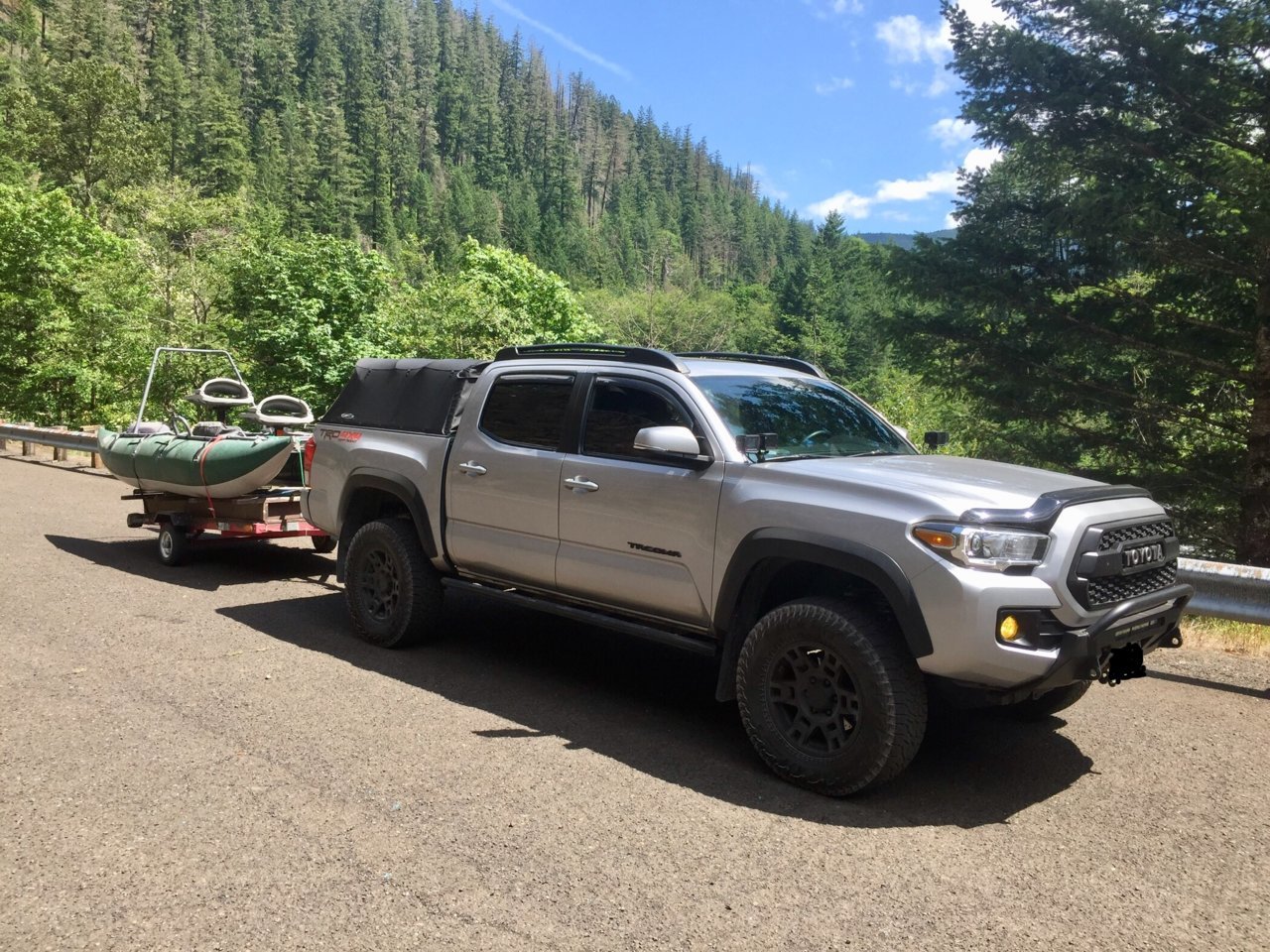

  10. Jul 23, 2019 at 10:49 AM
    SpeySquatch
    SpeySquatch Function over Form
    Mar 6, 2018
    #246516
    7,366
    2016 TRD OR DCSB
    C4Fab LoPro, BAMF Sliders, Ext ADS 2.5’s, 4.88's, OVTune (OG to KDMax)
    To help put it in perspective. I drive the same hill on my way home and with the tune, no gears, it always drops to 4th (without my boat) going up it.
    With the 4.88’s it holds 5th year WITH my boat in tow and the extra weight my truck has (not stock). I weighed my truck and it’s 5500lbs without the trailer and boat.
    Now my boat is not heavy, nor is the trailer (450lbs total or so), but I’ve never been able to hold 5th on that hill. The shifting just needs a little tweaking with the 4.88 tune and it should be cherry.
    Running 87 base.
