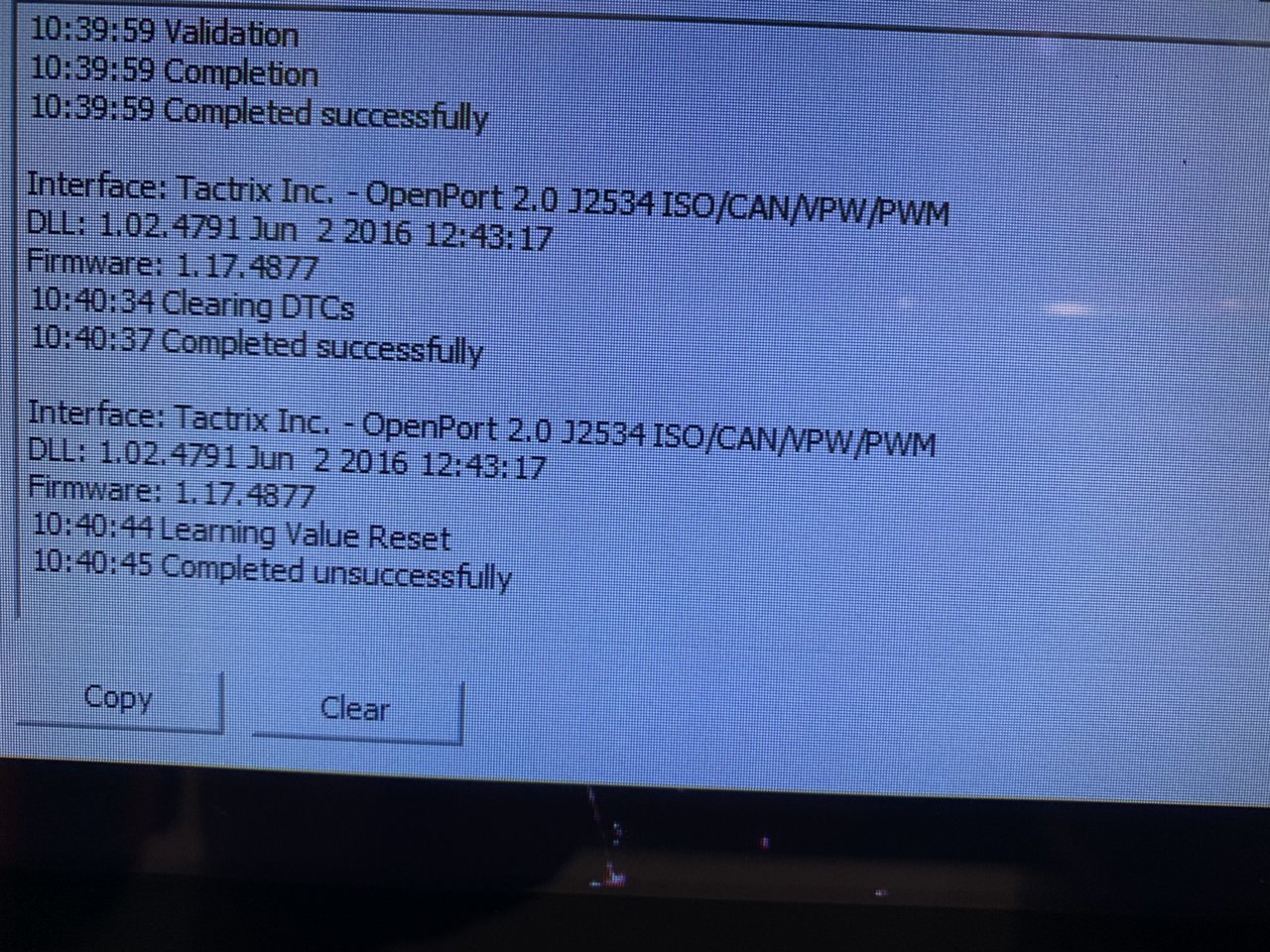

    Just verifying the steps before I flash "1.05 Base 87" over "1.05.1 Base 87":
    - Flash 1.05 Base 87
    - Reset DTC and LV
    - Start and idle
    - Turn off

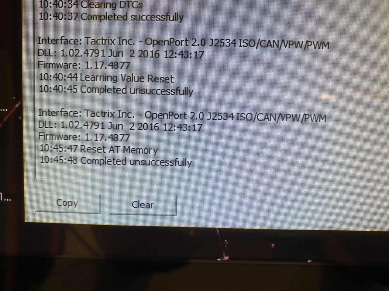

    So I did this and LV reset was unsuccessful...

    I wouldn't reset the engine lv just the trans lv. I just did the trans and my truck seems to be running freaking awesome. Avg is 21.6 mpg.

    Trans lv = DTC?

    No I think it says AT reset

    There no need to reset engine learned values in my opinion. It's just gonna screw up long term and short term fuel trims and give u shit gas mileage for hundred of miles.

    No luck with that either. Will leave it as is.

    I had about five thousand miles on 1.05.1 and it I started to have vibration issues and power loss so I went back to 1.05 and did not reset learn values for the engine just the transmission and the truck seems to be running phenomenal and getting better gas mileage than ever before.
