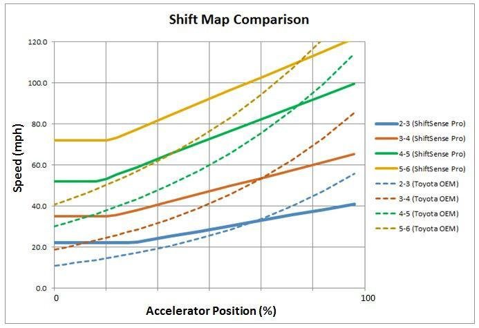

  10. Sep 18, 2017 at 2:06 PM
    #4730
    rnicholls
    rnicholls Well-Known Member
    May 10, 2017
    #218703
    722
    2016 TRD OR DCLB
    I'm not sure if you ever saw this, but the company that produced the ShiftSense Pro has this on their website. The dashed lines are stock. Between this and what you've provided I have to agree that Toyota was lazy/in a rush. I think we have the Colorado to thank for that.
    MOC221_ likes this.

  12. Sep 18, 2017 at 2:12 PM
    #4732
    rnicholls
    May 10, 2017
    #218703
    722
    2016 TRD OR DCLB
    Well that really wasnt the point of my post. I think the SSP is good for staying in the power band of the stock tune. What it's not good for is mpg, timings, etc. It's a bandaid.
    The point of my post was to showcase Toyotas laziness.

  15. Sep 18, 2017 at 2:17 PM
    #4735
    rnicholls
    May 10, 2017
    #218703
    722
    2016 TRD OR DCLB
    No worries. I could see how it could be viewed that I was asking for SSP shift points. Definetly a no. That shit makes my exhaust drone like crazy.
