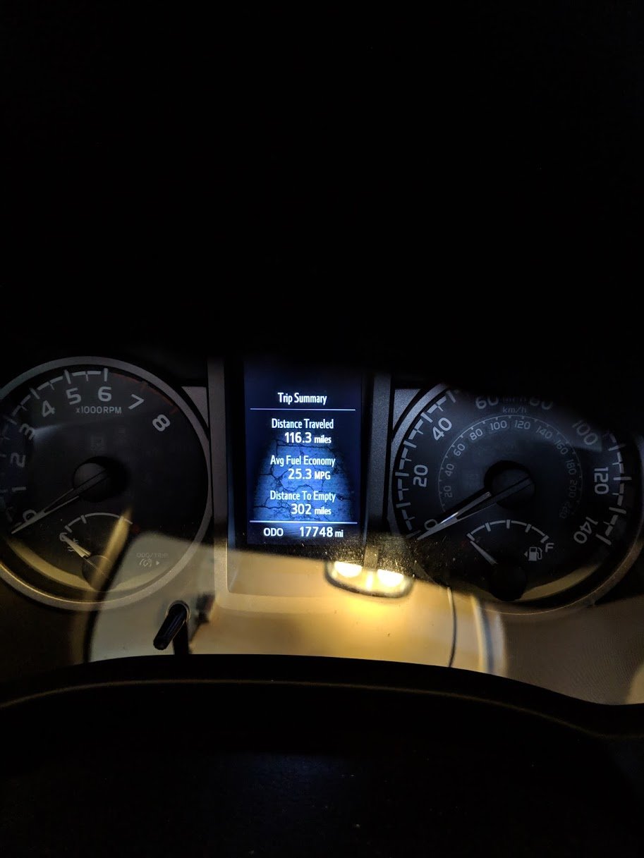

    Even then, the AT gearing and FD ratio don't really allow the best cruise MPG, IMHO. I think you agree since the 4.88 gears are missing from your post? :D
    A slightly higher than typical freeway run for me (at the time, the computer was showing 0.5mpg high):
    I will usually see 21 to 23 on my commutes, and my average is below.
    Shellshock[QUOTED] likes this.
