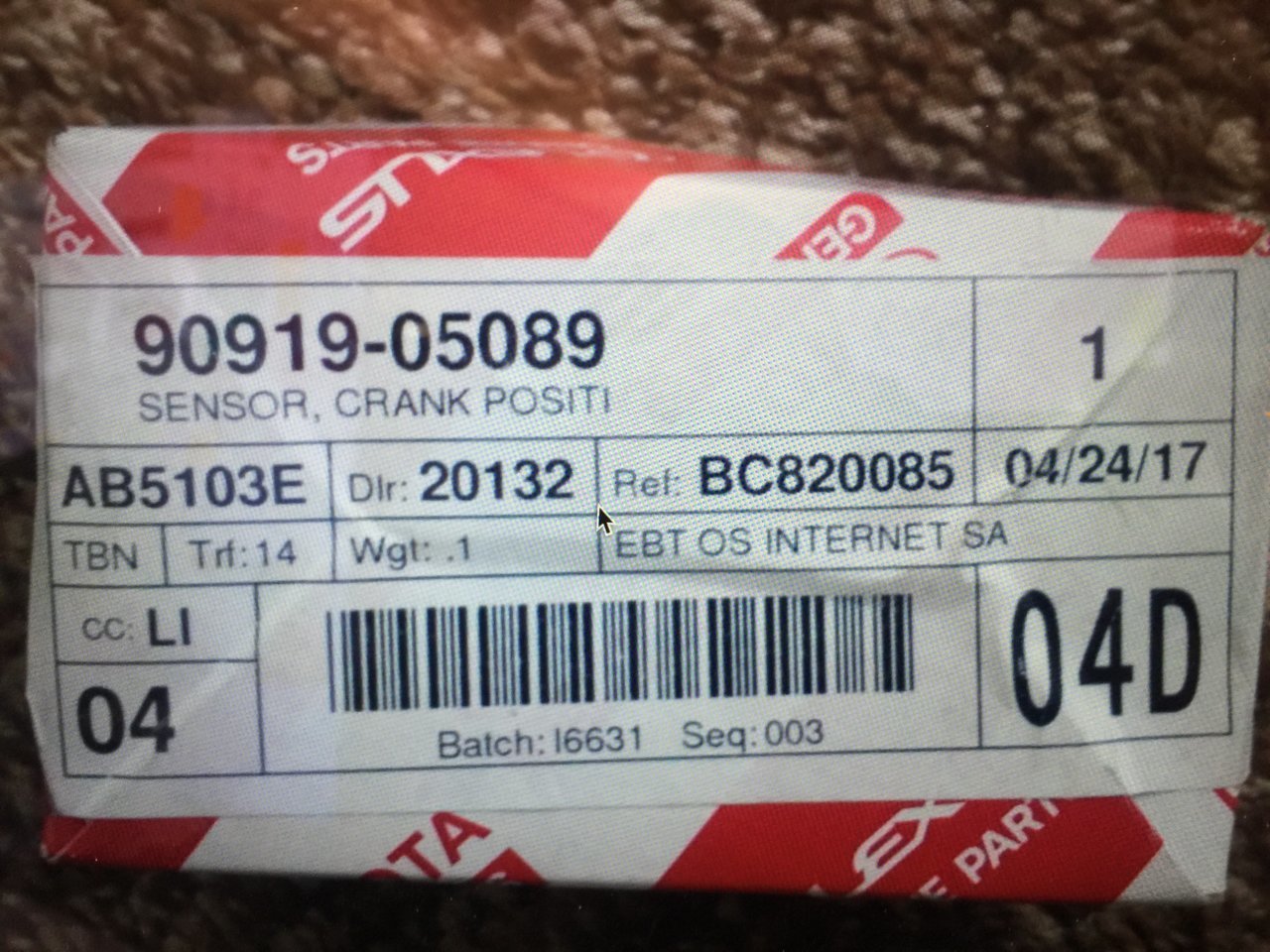

    CPS issue?

    By the sound of what happened the CPS is the most common culprit. Toyota has stated that when they coat the frames with anti-corrosion coating it can cover the sensor and make it stall out at certain parts of the crank rotation when going from a stop...like stomp on it and it dies.
    I would have them replace this part for you first. It’s a $100-$120 part. Pretty sure there is a TSB for it anyways

    Did you also see a trans over temp warning flash across your cluster display? IIRC that was also a classic "symptom" of the CPS issue....

    Further to this, and according to the documents Toyota produced WRT the CKP recall, SOME timing rotors (reluctor wheel) were manufactured with "excess anti-corrosion coating". This apparently caused issues with the original crank sensor, thus the re-design (much cheaper than separating the engine/transmission on affected trucks and replacing the timing rotor, as this beasty lives inside the bell housing). What's interesting though, is that Toyota wasn't 100% sure of the root cause, as they weren't able to reproduce the same fault definitively during testing. Anyway, as an owner of an early 3rd Gen and not on the recall list, I decided to swap my CKP with the new model anyway. No issues.

    I also replaced mine myself as a preventative measure.
