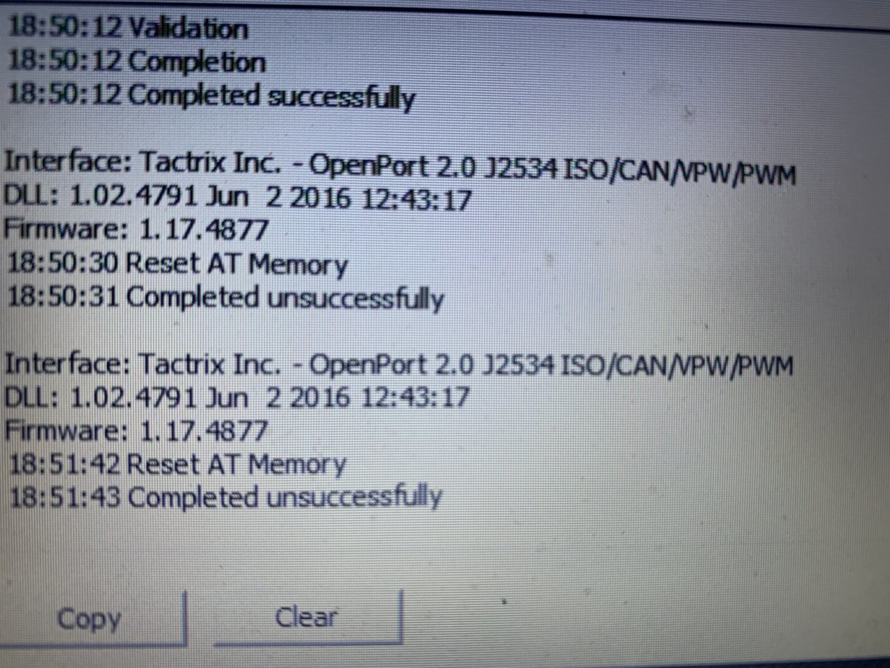

    That’s what I was trying to do was take it out of accessory mode. Maybe because I tried resetting the AT values twice (both unsuccessful)?

    Cool, but any idea why the AT values wouldn’t reset. Thanks man

    To reset the AT, you have to have the truck on (push button 2 times without starting), then reset the AT values. Not with the truck running, it will be unsuccessful.
