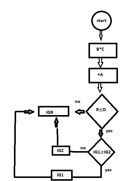

  16. Aug 15, 2019 at 12:11 PM
    OVTune
    OVTune [OP] Well-Known Member
    Mar 27, 2017
    #214557
    8,112
    OVTune
    it learns both ways depending on knock feedback
    sorry flow chart courtesy of ms paint
    our logic uses KCLV to multiply base retard, effectively increasing or reducing ignition
    then our ignition result is compared to MBT, use MBT if greater
    if less than, compare to stock ignition adaptation
    if greater, use our logic.
    this ensures you get *at least* as good as stock adatation but never greater than MBT limits
