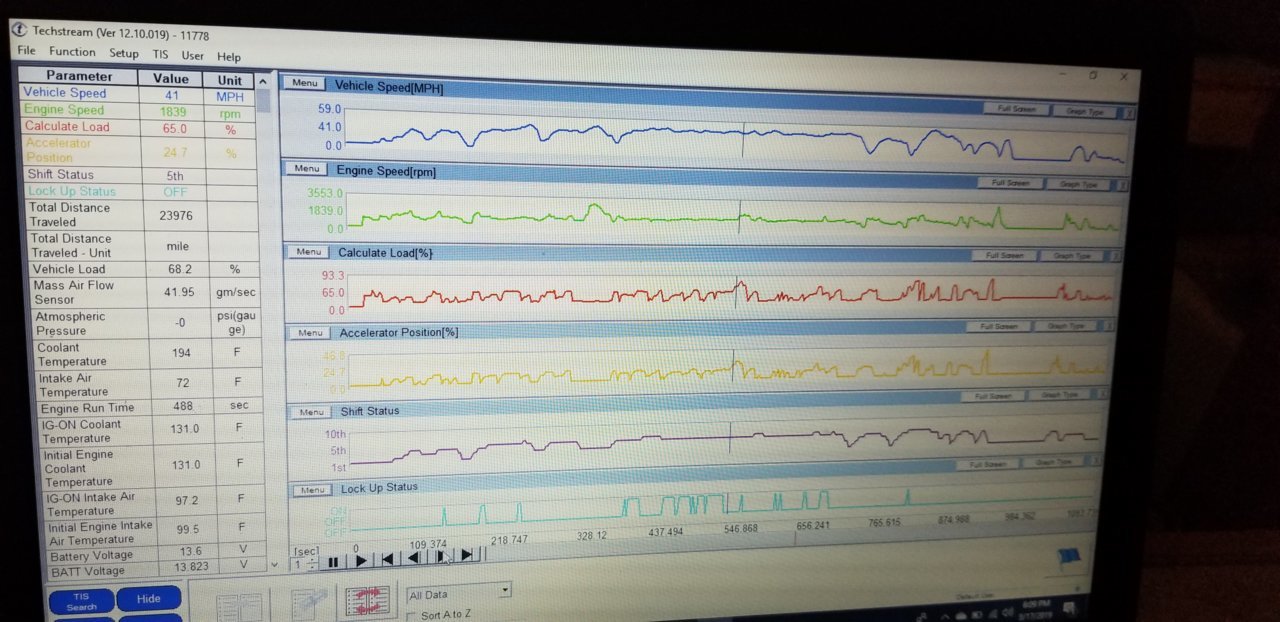

    Here is the pic of the data I logged.
    I see no dead pedal.
    See the vertical blue line across all graph.
    This is me coming to the hill in 5th (see left side for driving parameters).
    As you can see RPMs were rising as the position of the accelerator was moving up.
    I had a traffic in front of me and was unable to accelerate further.

  4. Aug 17, 2019 at 2:12 PM
    BEAR_KNIFE_FIGHT
    BEAR_KNIFE_FIGHT bearly famous
    May 21, 2016
    #187524
    2,628
    Alex
    Minnesota
    2016 TRD OR 4X4 DCSB Slowsand, 2017 WRX WRB
    delicious data, nice work there
  5. Aug 17, 2019 at 3:39 PM
    mattf00
    mattf00 Member
    Oct 14, 2018
    #269400
    13
    Québec
    2018 Tacoma TRDOR DCSB.
    Ovtuned, oME with Dakar leaf pack, ARE topper, Prinsu roof rack
    Speed is steady (I was decelerating in steep hill because gravity)
    load percentage is going up,
    throttle position is further,
    but still no downshift.
    That look like a “dead pedal” to me
    If the transmission was going in 4th gear it would be in the correct power band to “accelerate” or keep going. If nothing happens when you push the pedal there is something wrong.

    At your marker (vertical line) I see accelerator position increasing with no increase in speed... that's dead peddle. The slight increase in RPM is from TC unlock but it's not enough to increase your speed. 5th is overdrive and 6th is a double overdrive, with any increase in load and or peddle position should shift to 5th, IMO, for more efficient acceleration instead of lugging up to speed slowly.

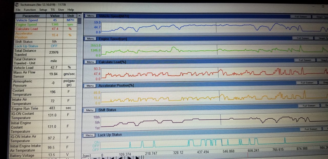

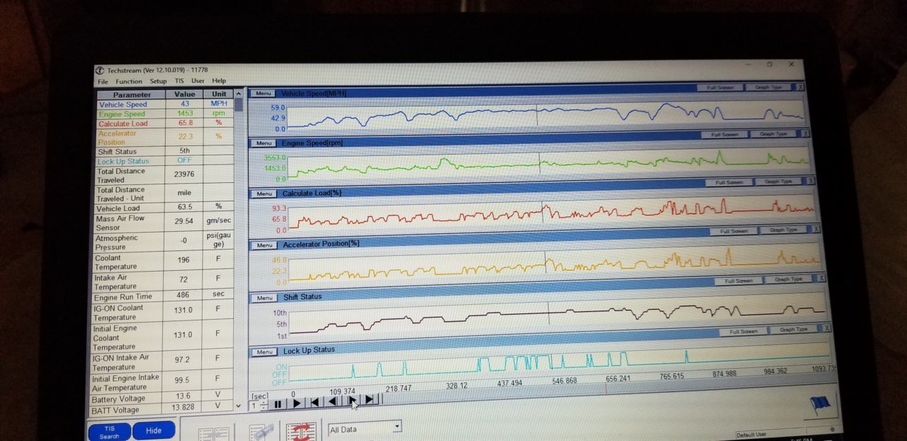

    It's a hill. Big ef'in hill. You'll drop the speed regardles what you drive. Plain physicsBut this is not a dead pedal.
    I tested that 93 tunes 10xx something version and I can recognize a dead pedal.
    I would drive 70+in left lane, 6th, tc locked. As soon as I hit a hill, pedal moved passing 40%, nothing would happen - still 6th, tc locked
    Here a 2 frames after the blue line.
    See TC unlocking (probably due to drop in speed) and moving accelerator by 9% caused RPMs jump by 400 and I recovered speed accelerator at 30.8 %, rmps @2050, load 83.5 %.
