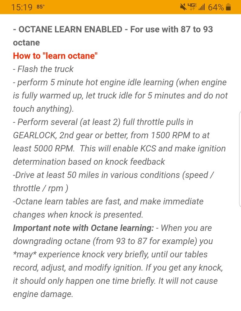

    from the orange virus web site

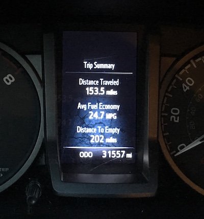

    Been running the 93 octane 2.0 beta for a couple tanks worth of gas now. All I can say is that @OVTune is a #$%^ing genius. My truck is consistently getting 2 to 3 mpg better than 1.05, AND it is a much more responsive, fun drive. Mileage and fun usually are mutually exclusive...
    Did a trip from Athens to Dayton this weekend - a mix of fairly steep hills and flat highways. Speeds varied between 60 and 80 mph, and I got nearly 25 mpg. To top things off, I was able to use cruise, even in the hills. The truck only needed 4th gear once, and it never hit 3rd. With every other iteration, from stock through 1.05, on cruise it would have been in 4th on every overpass and screaming at 5000 rpm in 3rd gear on several of the hills. In terms of throttle response, I used to run 1.05 base because I thought the performance throttle response was too twitchy. Throttle response on 2.0 beta is a good compromise - crisp but not twitchy. Yes, creeping forward/backward when parallel parking requires a light touch, but it's not scary the way the performance tunes were. So far, the throttle response has been consistent - it has the same feel today as it did 5 minutes after I first flashed 2.0.

    Any insight into what a “GEARLOCK” pull would be? Is that when you slide from drive into “manual” shift?

    You put it in the "S" mode with ECT on. It locks the truck into that gear.

    I still have to load the OLT 2.0 beta tune and was wondering the same thing about the gearlock pull. What did you do? Just put it in gearlock and did some pulls down the street between the given rpm range?

    Yes. The idea is to load up the engine and make a full pull. This will help expedite the learning. Of course, if you can’t do this safely, don’t. The ecu will eventually learn on its own. Think of it as starting off with an 87 octane tune and as the ecu learns it will increase from there, until knock is sensed.
