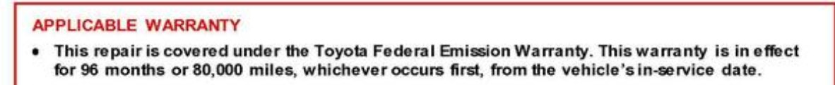

    @SteddyTeddy I had my truck reflashed/updated at the dealership yesterday. My ECU went from 030 to 040. There's a print out a few pages back, bring it in and tell them you're having the symptoms that the print out describes. They'll test drive it, and hopefully get you sorted out.

    @SteddyTeddy if you are going to the dealer, this is the key. You need to describe the symptoms and problems of the TSB to the dealer as the issue you are experiencing. If you just ask them to update the ecu, they’ll laugh at you and you’ll leave sad and disappointed

    T-SB-0062-18 is a good one to reference, because the symptoms happen only at high altitude. You can tell them that you took a trip to the mountains, and while you were at high elevation, your truck had a bad stumble at wide open throttle takeoff. Unless your dealer is in the mountains, there is no way for them to do a test drive to verify, so they'll just have to take your word for it and apply the TSB. Some other TSB versions for this same ECU update list symptoms that can be tested at any altitude, and if you have the bad luck of that particular symptom not happening during the test drive (or a dealer who lies about test driving it and just claims it didn't exhibit the behavior), they might refuse to apply it.

    When you go to the dealer don't tell them you want the update to install the tune. Dealers are trying to charge people $150+ for this free TSB
