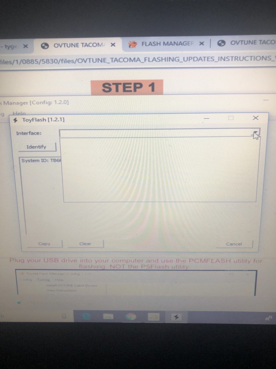

    Can anyone help me out. Why is the system Id not popping up in interface. 21E89ACA-4991-417D-88F3-2055442C3209.jpg

    It's not supposed to. You need to select the correct cable interface from the "pull down"

    Select tactrix- openport 2.0 from the drop down menu.

    You don't have an interface driver installed. That is an option within the OV software.

    Awesome. I got it. Thanks for the help

    Exactly, follow the video from the first post. It will walk you right through.
