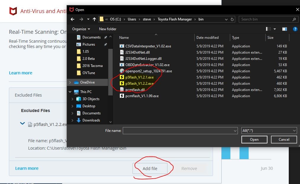

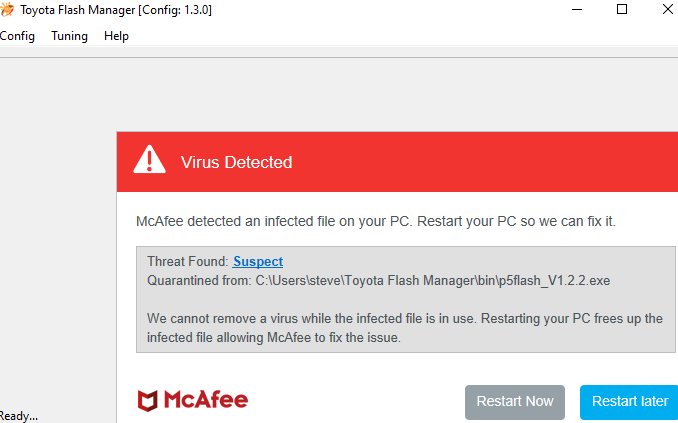

  11. Sep 10, 2019 at 5:47 PM
    vsekvsek
    vsekvsek Well-Known Member
    Sep 30, 2018
    #267918
    82
    Hey guys, using flash manager now. Just installed and downloaded. Keep getting virus detected even after turning off firwall and rebooting several times. This happens when clicking on Tuning>>P5Flash Utility. Was gonna retrieve my PC credentials per install instructions.
    Anyway around this?

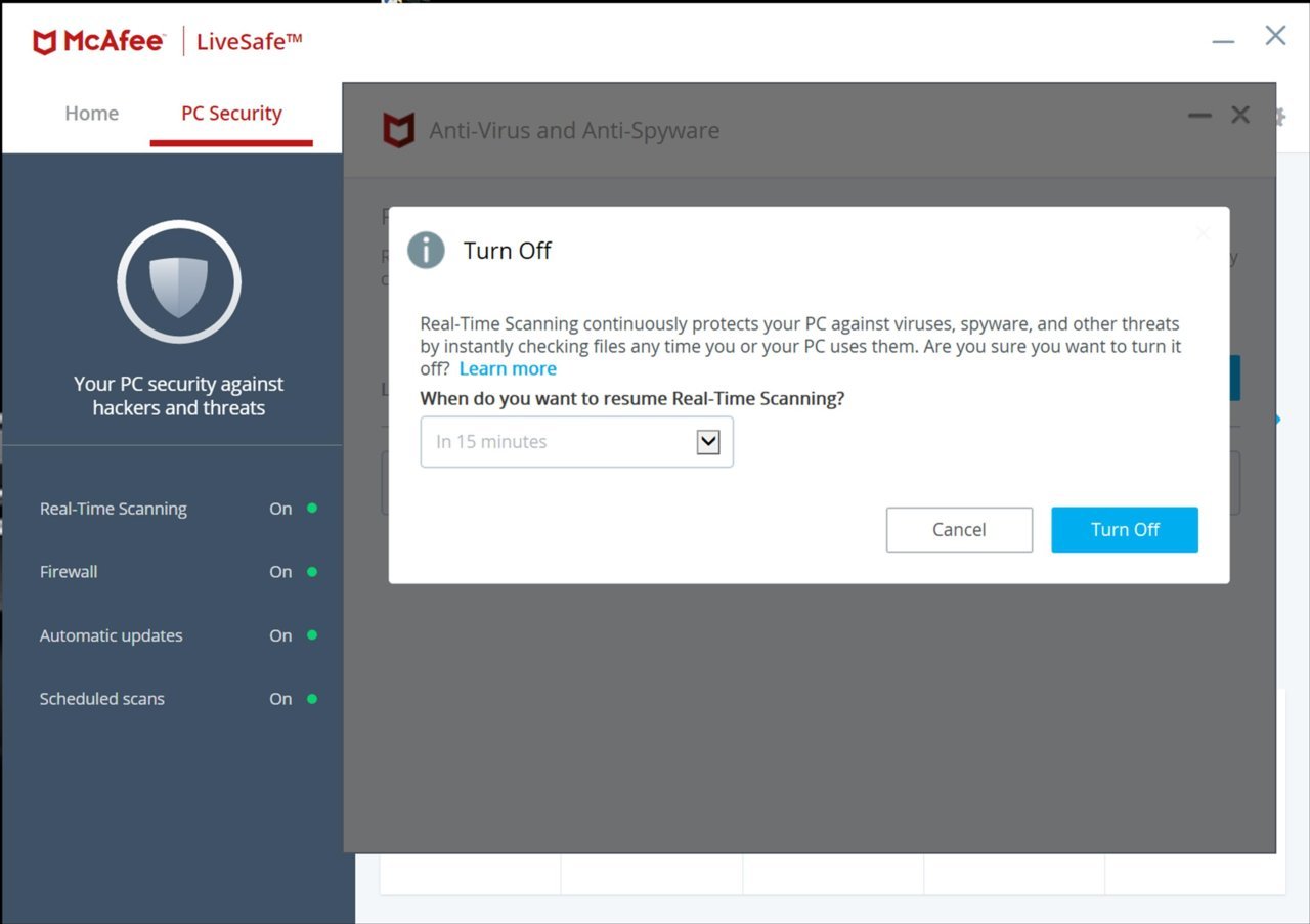

  12. Sep 10, 2019 at 5:48 PM
    lapoltba
    lapoltba Full Bridge Rectifier
    Aug 28, 2014
    #137089
    3,347
    CT - 06076
    '17 Sport, ACLB, V6,MT, 04B14 OV-Tuned
    It has nothing to do with your firewall. Turn off your virus scanner/threat detection. Alternatively create an exception.
  13. Sep 10, 2019 at 5:49 PM
    DES2009
    DES2009 Minister of Truth
    Jul 22, 2014
    #134426
    1,000,543
    Southeast Louisiana
    2017 MGM Limited
    I'm a Millionaire! One Million Posts!!
    Turn off Real Time Scanning
    vsekvsek[QUOTED] likes this.

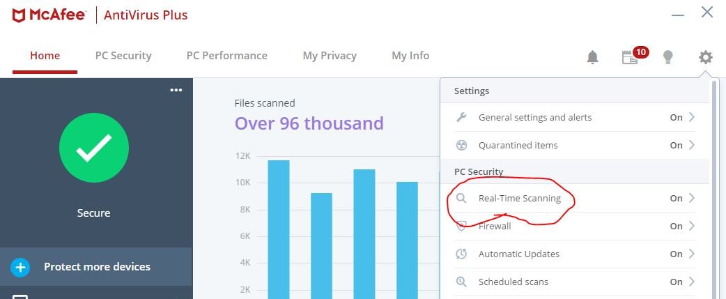

  17. Sep 10, 2019 at 6:10 PM
    FritoBandito
    FritoBandito Well-Known Member
    Sep 26, 2015
    #165230
    400
    Texas
    2016 Limited 4X4 DCSB
    Try this.
    1. Click on the up arrow in the lower right hand corner of your screen by the time and then double click the McAfee icon.
    2. Click on the gear icon in the McAfee window and then click on Real-Time Scanning.
    3. Click on one of the P5 Flash executables - I have more than one since I've downloaded upadates since I first installed the software so your files may be different than mine.
    Your flash executables will be on your C drive so open your C drive and go to the following path but replace YourUserName with your windows login name.
    C:\Users\YourUserName\Toyota Flash Manager\bin
    You want to exclude these files from real time scanning and following these steps should do this in McAfee.
    When you update the software you will need to follow these steps again to exclude the new executable versions from real-time virus scanning.
