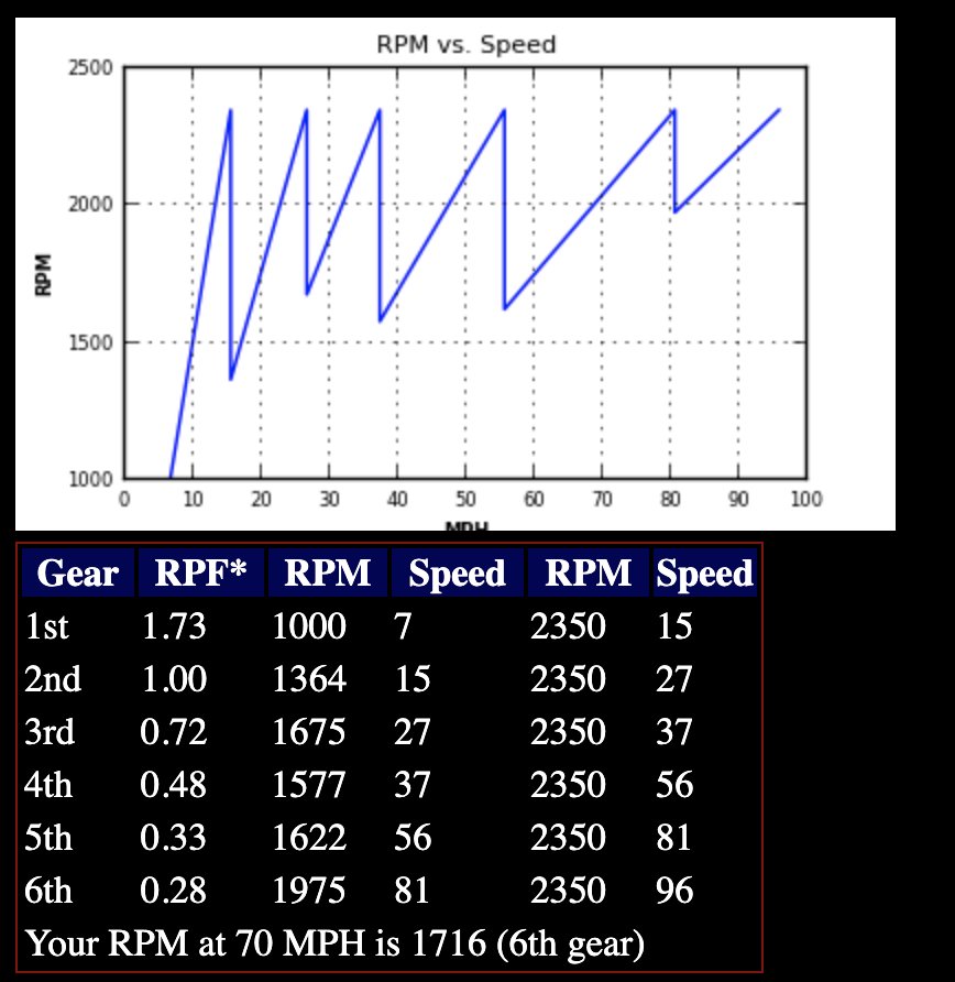

    I feel like the majority of shift complaints associated with the 3-4 shift will be difficult to resolve with the tune. Take a look at the jump between 3-4 in comparison to 1-2, and 2-3. Note the chart below is graphed with 6AT ratios, 3.91 rear axle ratio, and 31" tires, assuming a static shift point in all gears & 0% TC slip. You can gather how long the gears are in comparison to each other, visually.
    The 3-4 shift could no doubt be better, but at the end of the day, the gearing is what it is and won't be changing. Rear end regearing will help mitigate the double overdrive, but the leap between 3-4 can not be resolved without regearing the transmission, which is not feasible.

    Don’t you have gears? How are you lugging at 37mph at 1100 rpms?

    Best evidence of this yet.
    The 4.88 gears just help reduce the gap in that 3-4 shift compared to the 3.91’s.
    The giddyup is very cozy...let’s be honest
