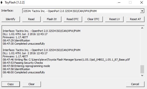

    So just tried to flash and I got a message telling me 12.4 volts. Please turn everything off to continue. Of course I continue and get an error message telling me it was incomplete. So do I need to put battery on a charger overnight?

    Should be fine, just cycle the key and erase DTCs and try to flash again

    It wasn't the voltage, I've done mine in the 11s just fine. You had it on but not in accessory? There is also a slightly different drop down option that tripped people up but I can recall which one off the top of my head. Canbus something option or other, LOL. Someone else will help us with that.

    I just wish I didn't have to disconnect my MaestroRR I use with my aftermarket HU. It interferes with the flash process otherwise :/ I don't flash that often but I have to take apart the dash and pull the wires (easy enough now) every time. Perhaps I can just pull a radio fuse:der:

    Does your headunit have the ability to display car stats (ie. RPM, MPH, AFR...etc)? If so, you just need to disable OBD2 communications in the headunit settings before flashing. I have to do that on my Pioneer headunit to get it to flash.

    OK I am confused. Did everything right up until "flash it" where I dont get any error messages. Just simply says this. Ideas? Tried it with keys in both positions and cleared DTC's before and after

    Well Steve, I had my accessory position completely off and flashed it that way. I used to leave the accessory on with the truck off but it wouldn't do it with the new app it seems.Either way that's the only way I got the truck to the 2.0 beta.

    Is your ECU ID 04B02 ?
    Verify that you are flashing the correct tune file.

    Its 04B04, re downloaded ones that appear for this. Cleared DTC's re flashed and same error. Admin desk time I guess?Capture.jpg
