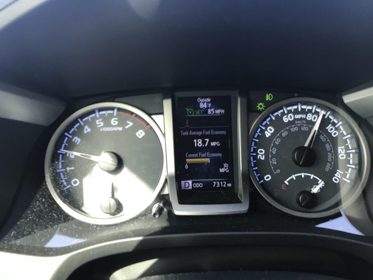

    04B30 2.0 Tune driven over 500 or so miles and I can honestly say the shift points are what a mini truck should be like. Older tunes it would always try to be get into the next gear and it lugged. Good power now where it should be. Downshifts correctly under light pedal. Doesn’t want to jump under light throttle from a dig. But I don’t know how anyone is getting their claimed great gas mileage unless you don’t know where the gas pedal is. Full tank, cruise control, Florida highway, 200 mile round trip, best I could do 18.5-19.0. Ya if I do 60 I mayyyy get 20-21 but who really drives like that.
    Want brutal honest opinion there it is. I’m happier with the 2.0 Beta. Trucks still slow. Can’t out tow my fathers Colorado or keep up and your gonna get 18-19mpg cruising at 75-85 mph like a normal human.
    Photo was after 1hr of driving.
