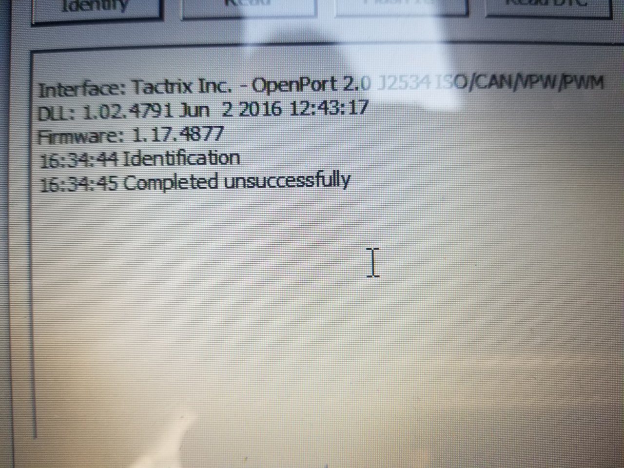

    Help...getting unsuccessful identity once plunged into vehicle

    Clear DTC power cycle the truck and try again.

    Thx for responding....how do i clear the DTC

    There is a button in the flashing program.

    Still unsuccessful....thoughts

    Is ignition on?

    Just the one button push

    Cleared again and it worked...thank u

    Two presses, not one. One press is ACC and two presses is IGN ON.
    that might have been your issue.

    OVtune successful..thank you
