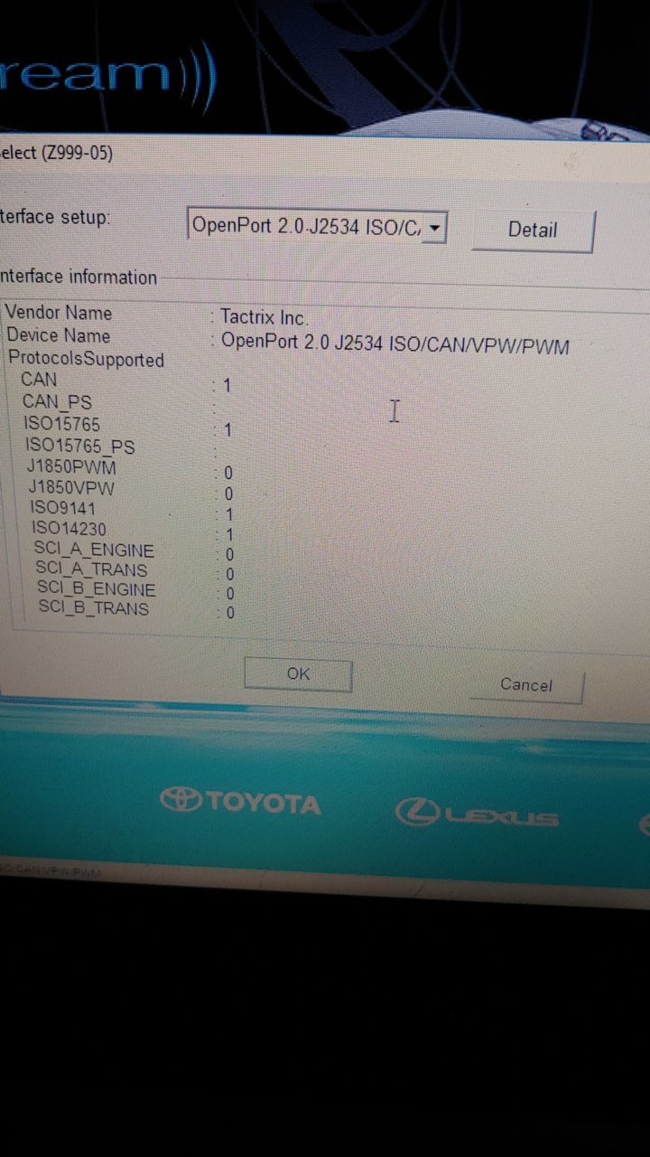

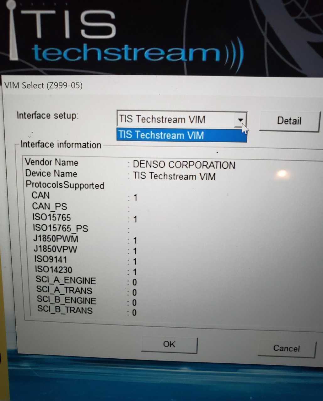

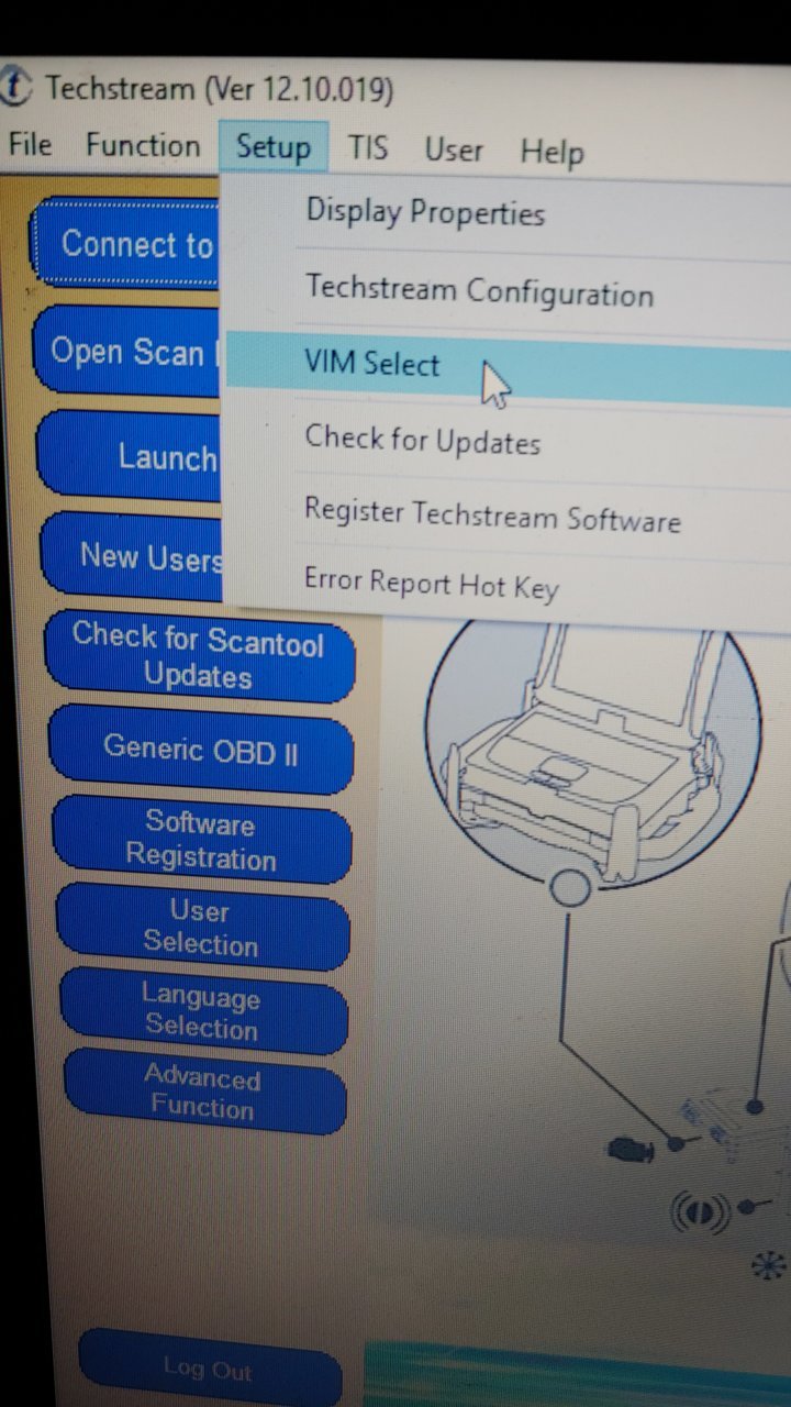

    i know it's been posted, but i can't find where the instructions are to know what calibration my truck has. Anyone have a link? I've already Dl'd Techstream
    Edit: I am getting an error that TS isn't connecting to VIM. So I guess the obd connector isn't communicating with TS on my PC, any ideas?

  7. Oct 4, 2019 at 12:01 AM
    Venator_2033
    Venator_2033 Well-Known Member
    May 12, 2017
    #218844
    131
    4" inch lift Dakar leafpacks/Bilstein 5100 B110/Fox 2.0 coil-overs/Catless Dual Exhaust w/H-pipe/OVtuned1.05/RCI Sliders/HID kits Hi/Low/AFE Intake with scoop and 76mm throttle body/Total chaos Fab UCA's
    In techstream click on setup then click on the VIM select option and make sure that it shows open port 2.0 in selection box.

  8. Oct 4, 2019 at 12:18 AM
    LTacoman
    LTacoman Well-Known Member
    Sep 9, 2015
    #163807
    1,472
    Luis
    Gilbert, Az
    2019 F150 Lariat EB
    Doesn't look like I have that option. I have the obd adapter and the USB connected:
  9. Oct 4, 2019 at 1:02 AM
    Venator_2033
    May 12, 2017
    #218844
    131
    Looks like the drivers aren't installed as it should show up with the drivers installed. Drivers for the tactrix adapter that is.
