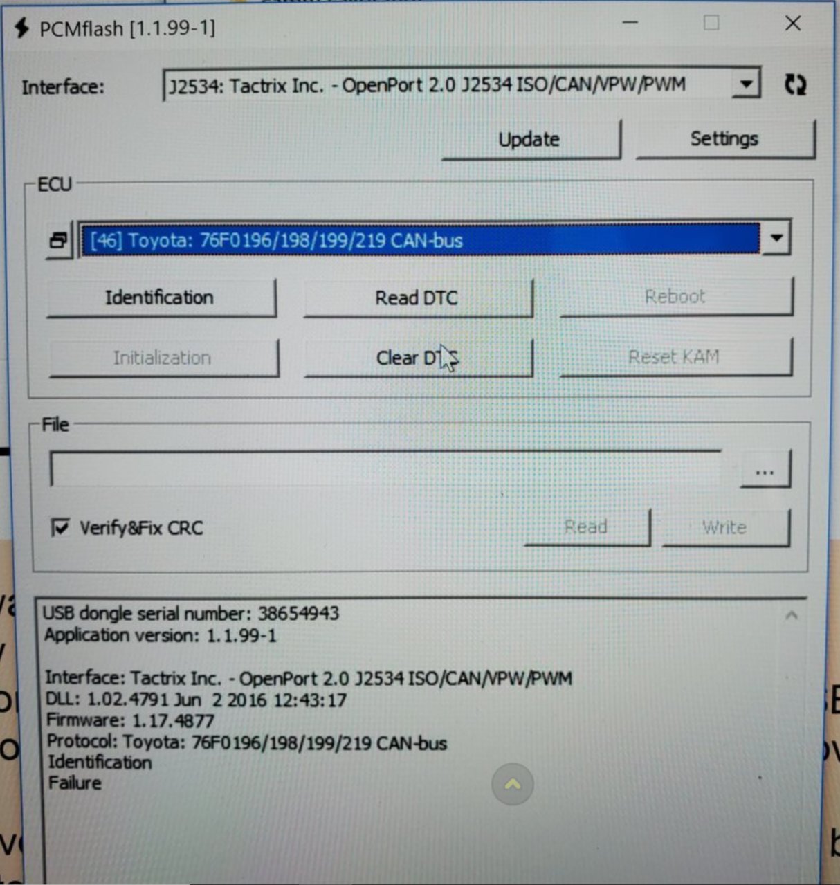

    Can anyone help me out here? Trying to figure out my ecu ID so i can update to 2.0 and Im stuck here. All the software is updated and required drivers are downloaded.

    That is not the flash manager though. He is on the right version of PCMFlash, its the same version I have.
    Also looks like his guardant drivers are installed since it actually launched.
    @youngster77 do you have the folder with all your tune apps and files excluded from your AV and windows defender? And is your vehicle in the Accessory mode? Thats 2 presses of the start button without pressing the brakes.
    edit: its 1 or 2 presses without brakes. It will tell you at the bottom of the screen in between the speedo and tach.
    double edit: confirmed from @ihatemytruck "Ignition mode, not accessory......2 pushes of the start button with foot off the brake."

    Vehicle was in accessory mode, 2 presses of start button without starting the truck. Windows defender is off. I'm on a new laptop because my previous one crashed so the only tuning files I have are the ones I recently downloaded.

    Are you "dongle" or "no dongle"? If "no dongle" then you need to register your new computer with Mat. THIS is the beauty part of having a "dongle".
