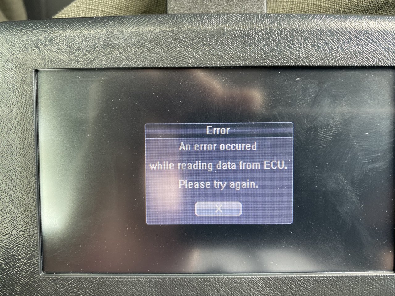

    I received the instructions for the HH accessory and I was wondering after I flash to stock and read with the handheld will I be able to flash back to a tune with P5F or will I only be able to use the handheld to flash from this point forward?
    Thanks.
    Edit:
    I went ahead and tried to read my stock ECU after updating the accessory HH but it didn’t work. Got this message.
    Not a big deal. I just wanted to get the HH registered ahead of 2.0 final but I’ll just wait it out.
