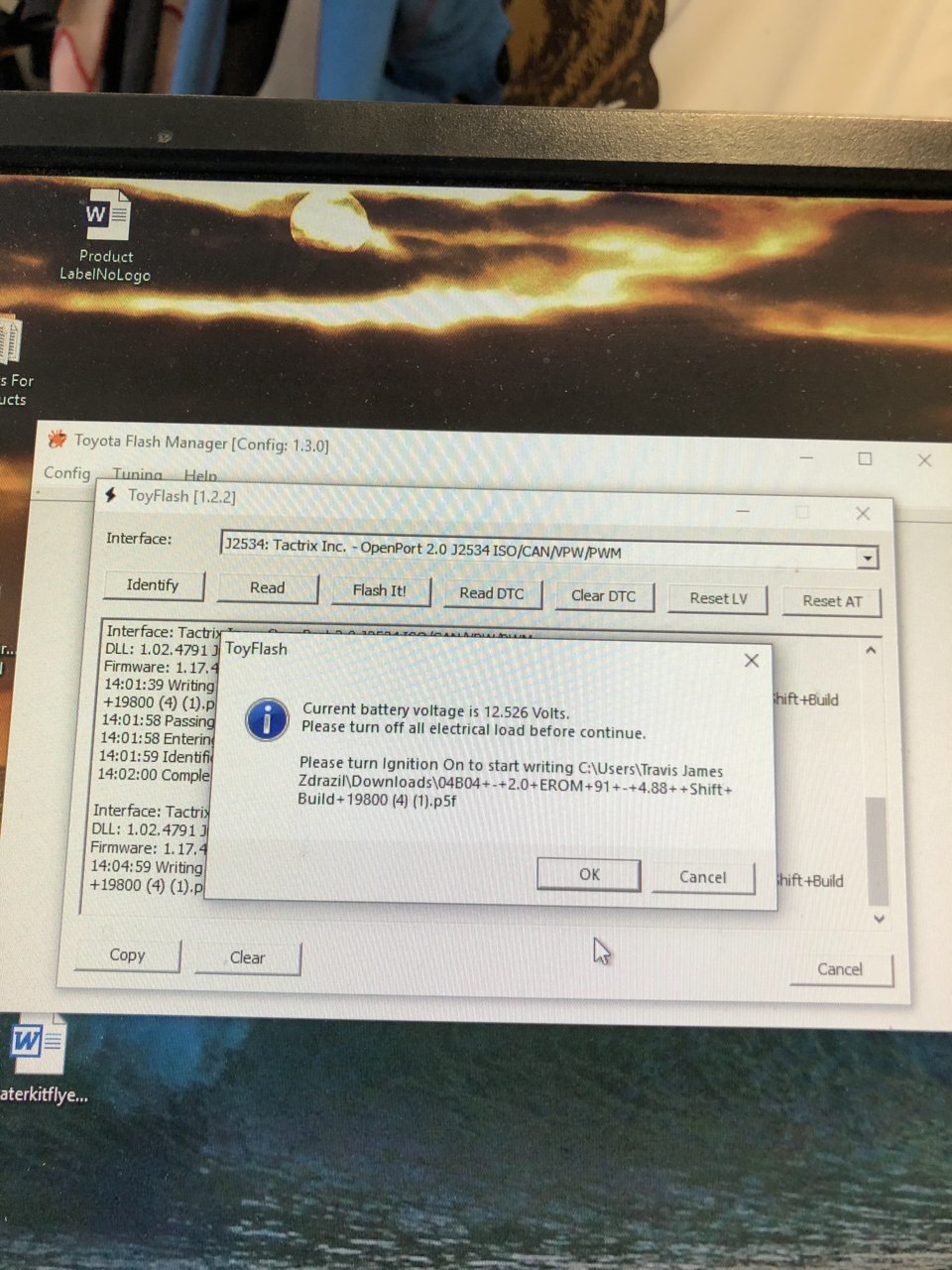

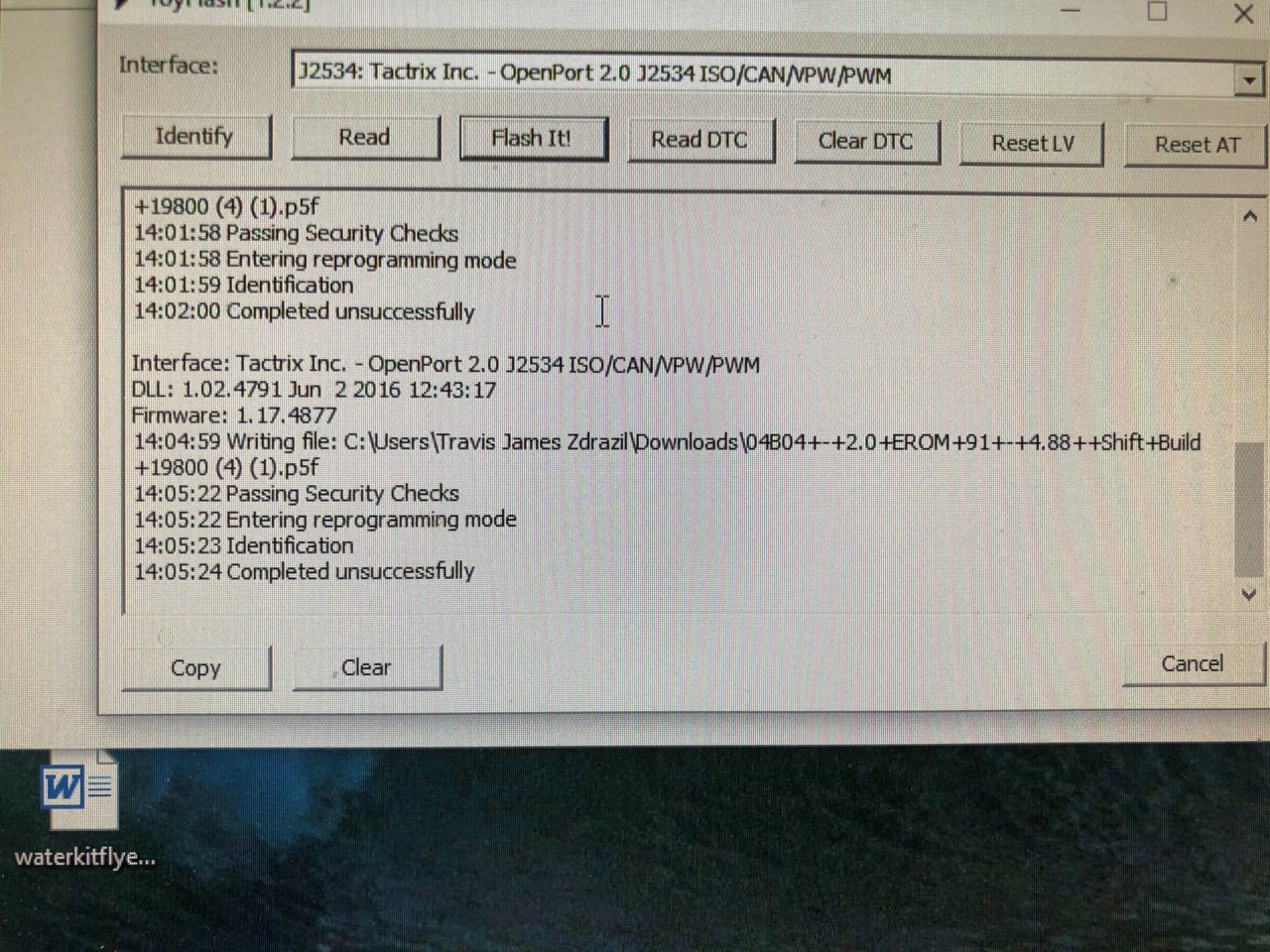

    Hey guys so I’m having some problems flashing to 2.0 4.88 tune. I currently have 1.05 from when it came out last year and haven’t tried flashing since then. I went through all the processes of downloading the new Toyota flash manager and doing each step correctly when it comes to flashing but when I flash the truck it goes for a second and then just stops. It reports I have low battery voltage but I tried disconnecting all my accessories and still reports the same. Any thoughts as to what I need to do?

    Make sure your truck is in ignition mode with two button presses foot off brake, as the error is saying that you need to turn the ignition on.

    Go back to the Toyota Flash Manager - select No Dongle, the proper year ('17), - don't worry about selecting a tune to down load, then go to the help button and click on UPDATE. Then go to the "Tuning" button and select P5f utility and then "flash it" and then select the tune you have saved in your download. ??

    Delete all the files you downloaded, then download the file again.
    The file you are trying to flash has a (4) and (1) means it's trying to flash a copy of a copy of a copy of a copy etc
    Also quadruple check your ID matches the file ID
