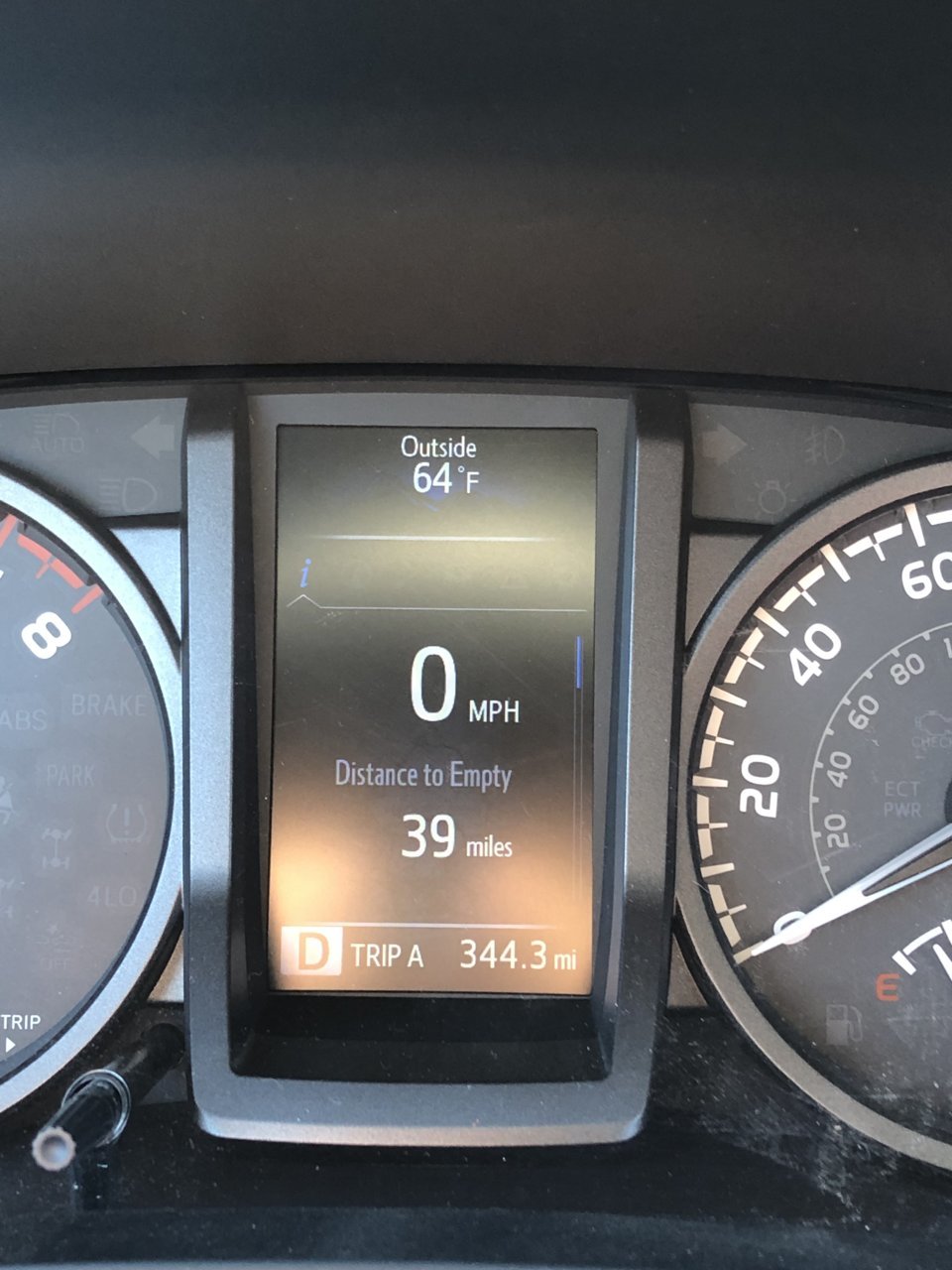

    Best mileage out of a tank to date. This was 90% highway miles from Bend to Portland and back, with one mountain pass at Mount Hood in each direction.
    2019 OR DCLB w/ SnugTop ExtraVision Shell
    04B31 - 2.0 19800 87oct tune

    I’ve done that and the Santiam pass many times. Nice work
