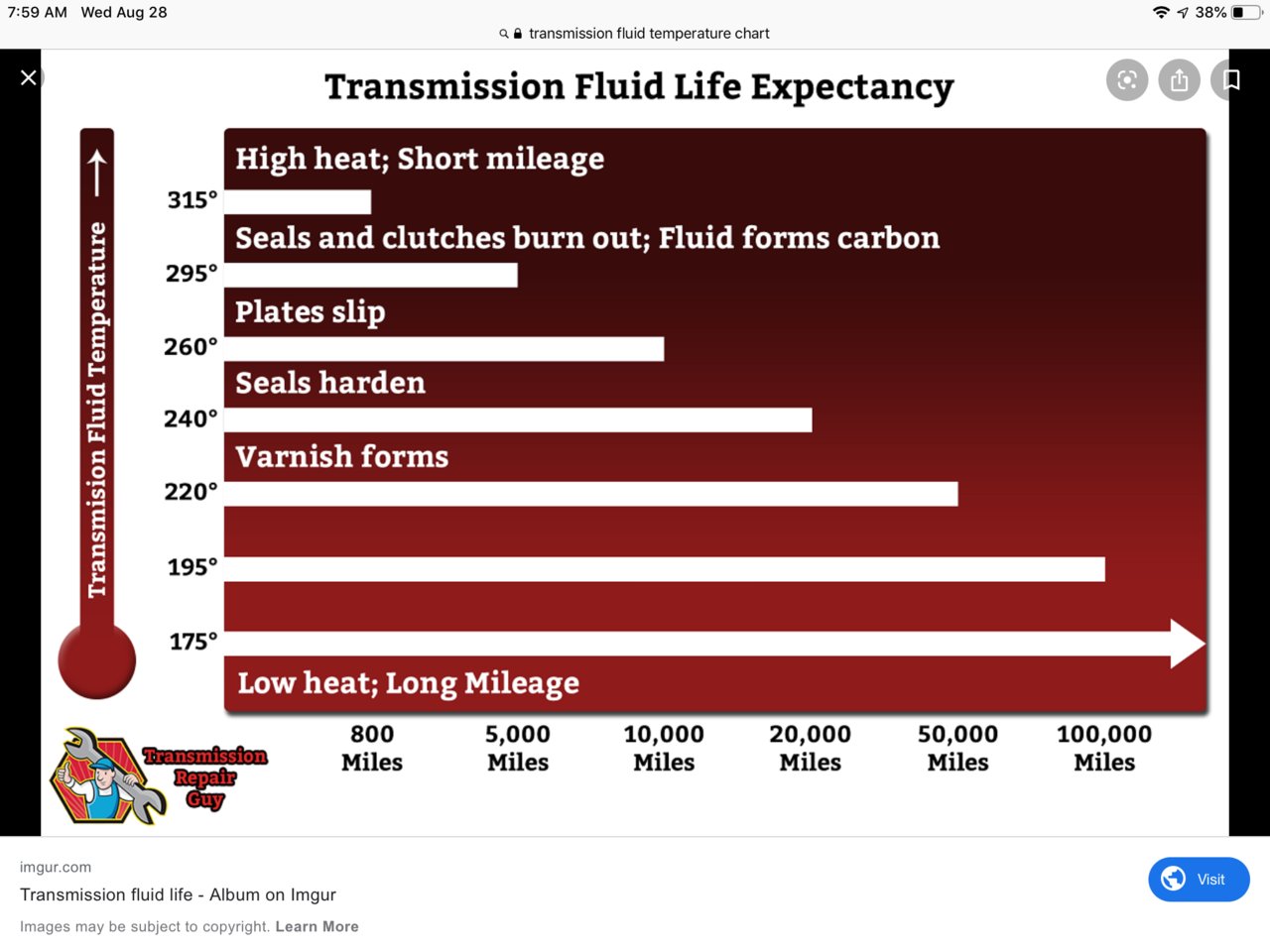

    Hmmm. Wonder why the Toyota engineers designed that T-stat to open at 190F...
    Drive that sucker.

    There is pan temp and TC temp. The TC temp will always be higher under load because you are shearing the fluid in the viscous coupling that is your TC. Within 5 degrees of engine water temp is likely as good as it gets for pan temp.
    I’m not saying that lower temps are not generally better for lubricants but these temps are not excessive.

    I assumed it was like temp and that the TC temp would be even higher which is why I didn’t like what I saw. The app I use doesn’t say where the temp is measured so I’m not sure. I just don’t like to see it. I’m not saying it’s bad based on science, but my old school brain says no bueno.

    The brown color was likely not temp related but clutch material which is quite normal. I have seen Toyota trannies go many hundreds of thousands of miles with the fluid never being changed. Synthetic atf can survive well above 200 degrees and still be doing its job. The tundra transmission sees temps that high all the time and is a proven transmission capable of going to at least 500k without a fluid change. The old saying is true, just because it’s black doesn’t mean it’s still not motor oil. Same for transmission fluid. Just because it’s dark red or even brown does not mean it still isn’t good fluid.

    It's going to exceed the threshold for fluid measuring temp (98-115) unless your trip distance is down the driveway and back. If you are sub-zero for normal ambient temps then pinning would not be a good idea. Not sure what cold is for you - I keep mine in the garage so even freezing (32) equates to internal block temps of mid 40's and by the time you let it warm and drive a 1/4 block it is up to 70. Viscosity not an issue at either temp.

    ^^^ This is you want to know as related to this

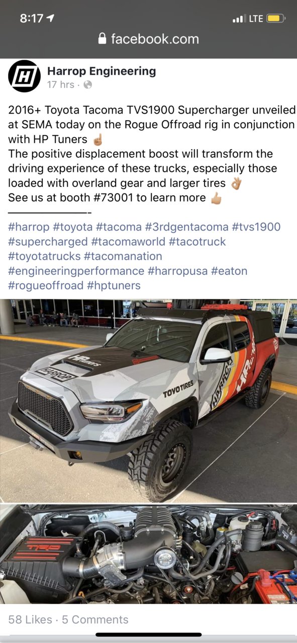

    Oh my, guess there was left over candy from Halloween @OVTune , another competitor, can this be squeezed too?
