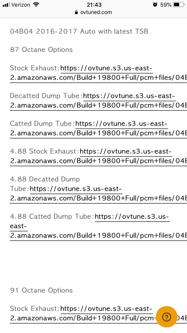

    I haven’t updated my tune in awhile. I have the 04B04 ECU without the TSB. Can anyone tell me if I need this TSB to flash the most recent files?

    No. 04B04 is the compatible (best) one

    Check again for the tune labeled ‘4.88 stock exhaust’ .... either 87 or 91 octane

    Scroll down past 04B30

    Thanks, I checked again and I’m seeing two lists for O4BO4. But those say “04B04 2016-2017 Auto with latest TSB”.
    Maybe I’m misreading it. Is that the tune plus the TSB or is the TSB a requirement before flashing?
    And since both list seem to be labeled the same, what’s the difference between the two?
    Sorry, I realize I’m way behind on the current status of the tune..thanks for the help.

    If your CALID is 04B04 then you have the ‘latest TSB’.
    One list is for pf5 flash (no dongle) and the other is pcm flash (dongle).
