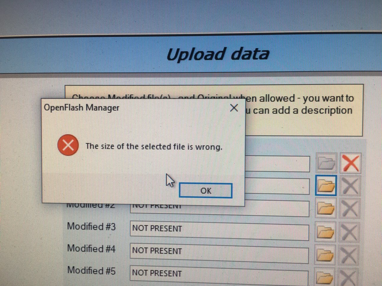

  5. Nov 23, 2019 at 7:47 PM
    smikec
    smikec Well-Known Member
    Nov 11, 2018
    #272376
    393
    Yes, I saw your other post (very helpful)
    But it implies you had to get the files by email (your point #5), not the ones posted on the ovtuned website beta page that I asked about.
    See post #54252, where member shellshock suggests the same.
    Attached is the error I get trying to upload the website files.
    No biggie, I've emailed Zendesk for the files, just haven't heard yet, but I'm sure they are busy (no complaints)
    S
