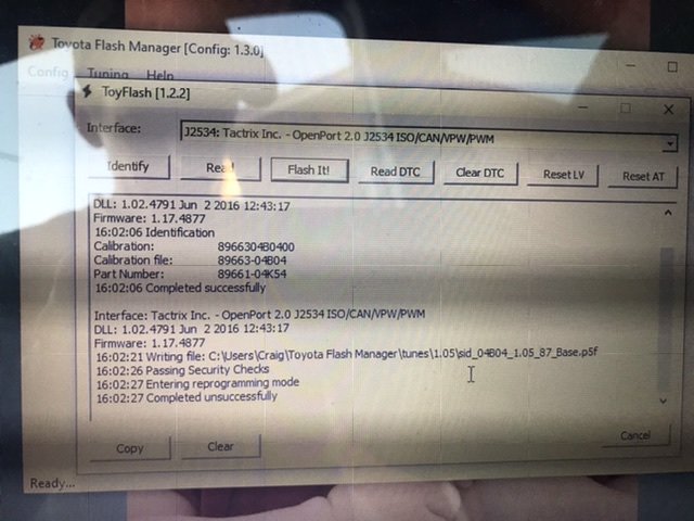

    Hoping someone can help. I’ve downloaded all the software and updated. got the registry key loaded. i hook up to the truck click identify and it reads i’m on 04B04. I downloaded the tune i want to try. 1.05 base. click Flash IT select the tune. a window pops up stating my trucks voltage and to turn off all electrical components. i click ok and it begins the flash. gets to “Sceurity Checks” then fails. i’ve tried different tunes and tried multiple times. here is a pic of the screenB50C6B72-528E-4982-8031-0A76B318DADF.jpg
    Please help

    Also try clear DTC and then turn your truck off and then back on if turning all the antivirus software off doesn't work and make sure you've put all tuning software and tune files in folders that you've made an exception for in your anti virus software as it'll save you a lot of head ache in the future.

    i have windows 10 and have the antivirus scan turned off before installed. where would i turn off “real time protection” not sure where can’t find it when i search windows

    Start/settings/update&security/windows security/virus&threat protection>manage settings: turn real time protection off

    Google how to add exceptions for windows defender win 10 and add OV folder

    Figured out my problem. If anyone has an aftermarket stereo head-unit that has OBD2 communications (digital gauges) you have to disable OBD2 communications on your headunit. I have the Pioneer AVIC 8400 NEX to disable OBD communications it’s in the setting tab when the gauges are displayed on the screen. Thanks for the help with the antivirus crap on windows i’m sure that was another issue i had. Flashed 1.05 base and WOW what a difference and it hasn’t even settled yet.
