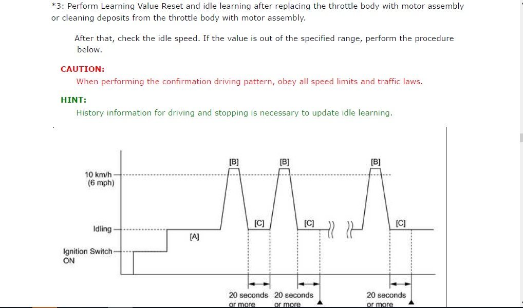

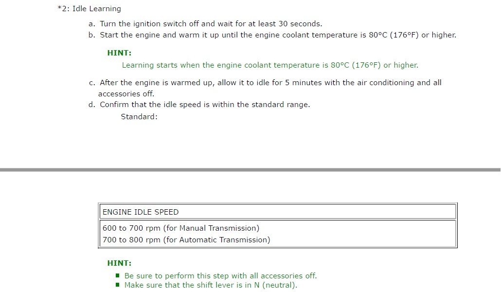

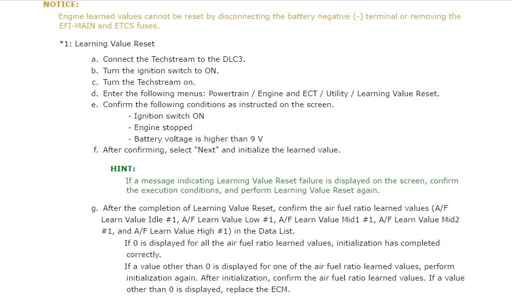

    The reason for letting the truck idle after flashing is to allow the truck to relearn it's idle values, but unless you've let the truck get to operating temp before flashing there's no point in letting it idle, as the manual states the truck will only begin the idle learning process at operating temperature.
    These were posted awhile back but strait from the manual.
