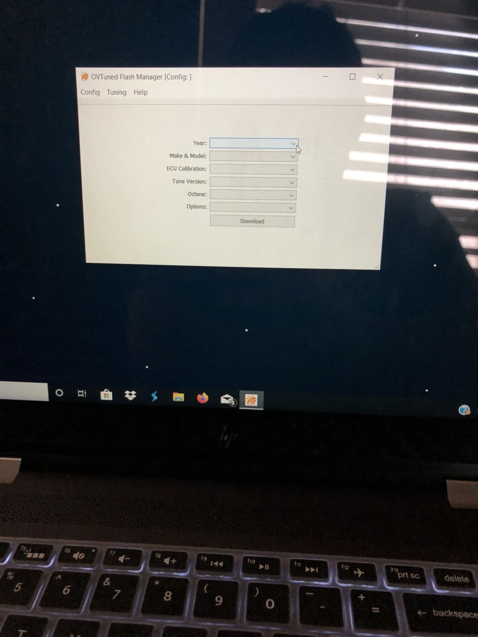

    So I haven’t open flash manager in a while. So I updated to latest, but now nothing comes up when trying to select tabs. Anyone have any idea why?

    Mine was same when I first purchased couple weeks ago. Only reason I know is because it happened to me. All I did was follow instructions on website to do everything OVTune required for a registration key. Upon hooking up to the truck for the first time it worked from that point on. Not sure if that helps your situation but did me. Just needed first initial wired hookup to the odb port

    Did you make sure to uninstall the old flash manager before installing? Also I would make sure to uninstall the new flash manager and to make sure all files are deleted by checking both the install folder and using the purge all data option in flash manager as you might have some old files left over from the old version of flash manager causing conflicts.

    Purge all data did the trick. Thank you sir
