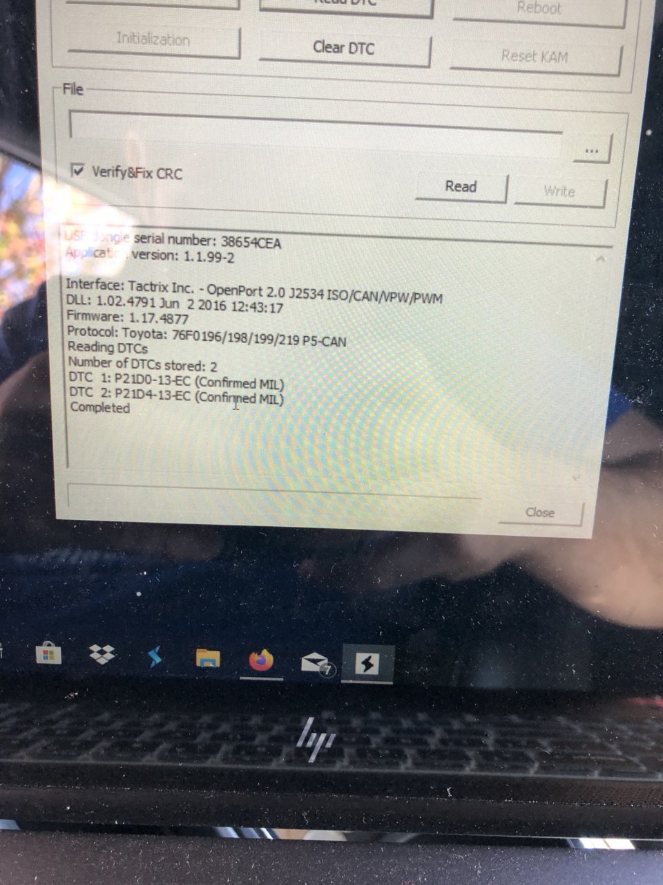

    So I woke up this morning with check engine light on and trac off and some engine hesitation(misfire?). I checked the gas cap and it’s tight. I was just driving it last night and it was fine.
    currently on latest 2.0 beta version 04b04 17 Tacoma. Any suggestions? Dealer is closed today. Was thinking of revert back to stock, but flash manager only has p5f file and I’m on dongle version.

    OVTune
    use our software, click READ DTC and send us the Code

    Isay
    2017 Tacoma TRD offroad
    Here it is Matt.

    Did you not download and save the 2.0 file that you can use to reflash after checking the codes for Mat? You should also be able to clear the codes with flash manager IIRC,if not download Techstream and do it.

    I have not reflashed the 2.0 file. I cleared dtc but it came back on. ill wait to see what Mat says. i tried using techstream before in the past, but i didn't have any luck connecting to the vehicle.

    This is an interesting code. Injector circuit open. (port injector)
    I can only find one other documented case of this happening to a Tacoma, and it was a mouse or other critter that chewed the harness.
    I'd pop the hood and take a visual inspection of the wires around the injectors
