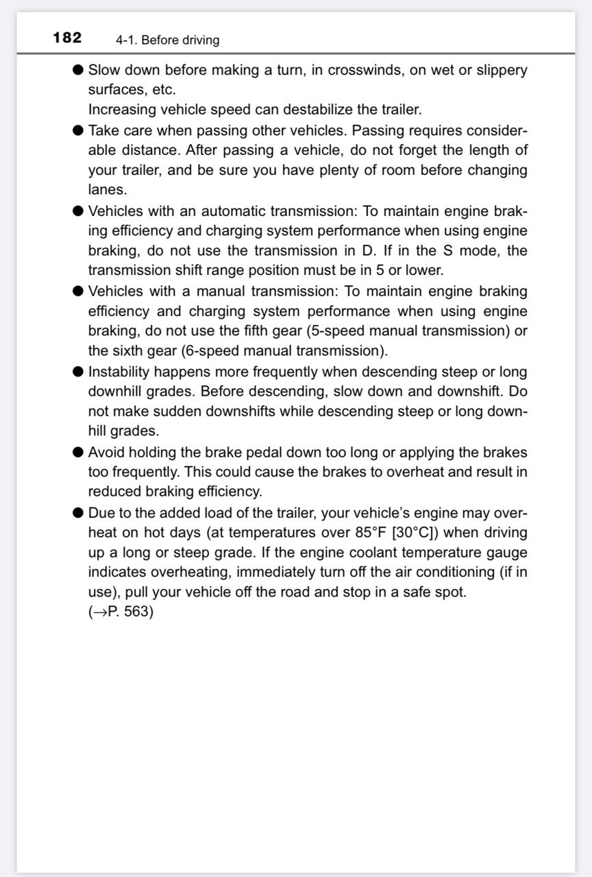

    I always wondered why it defaulted to 4th when going into S mode, seems it should stay in whatever gear you currently are in, what is the factory setting, default to 4th?

    Manual says towing should be limited to 1st-4th gears. That’s my guess on their logic.

    it’s actually 1-5 for towing

    I stand corrected. Updated opinion: yeah, auto 4th sucks. :rofl:
