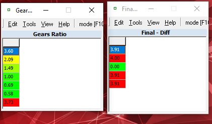

    The good news around this (for 4.88 and 5.29 guys)
    We have full control over Gear ratios in the ECU, and the gear ratio algo,
    and can change it
    so shift tabling can be corrected properly.
    (the ECU rounds our 3.909 to 3.91, with actual calc of 3.9089x)
    Lets see if it still occurs with our 5.29 map for 2019
