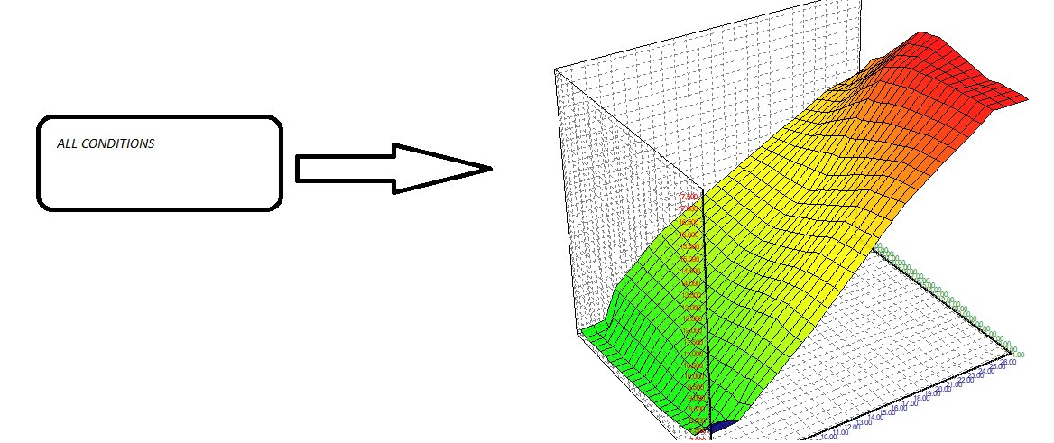

    OVTune
    I don't want to get too detailed on the stock path. Figuring it out is hard, and I suspect there will be competitors in this market before long.
    But here is our path.
    This table is designed, coded, and created exclusively by us. Doesn't exist in this size, form, etc in the stock ECU.
    every condition, every look up, all code sections.
    We had something similar to this in the past, but missed certain conditions in the code which would look up different tables.
    That's eliminated.

    OVTune
    A lot of simplification being done, redundancy removal and eliminating some of the sections that do all the table swapping.
    here is our single Throttle angle limit (base) table. No more throttle angle lim by gears.
    No more "tip in is xyz" from you guys.
    This table is 100x in size. and covers every possible location your foot could be in on the gas pedal.
    For reference stock table is 16x in size.
    I don't want to hear about "tip-in" ever again lol

    I remember posting this before, but anyway here it is again.
    for example here is a Thx limit on one of the gears.
    16% gas pedal = 3% throttle add
    Yes, that table + about ...15 more
