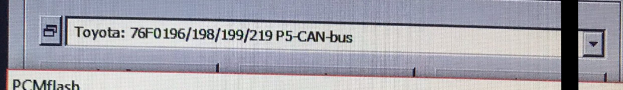

    Yep. Please drive at least 100 miles before reporting back!
    Sometimes I’d think “damn this one isn’t any good” then I like it more and more. It takes time!
    And what he means by “all of these files are for the ECM”:
    Here’s the video I made:
    https://youtu.be/nNCl2tAu-Pw
