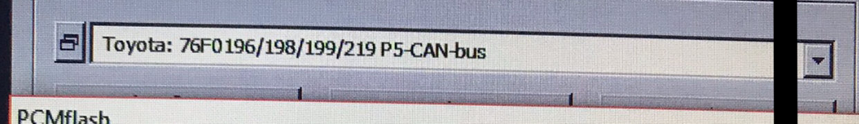

    Alright guys, here’s the process:
    Order a kit
    You’ll receive a tatrix OBD cable and a guardent security dongle.
    Youll input your dongle info into the PCM flash software (which you download on your own)
    This will allow you to read your ECU data.
    Read ECU data
    Email the file to Matt.
    Matt will reply to your email with a file for you to write to your ECU
