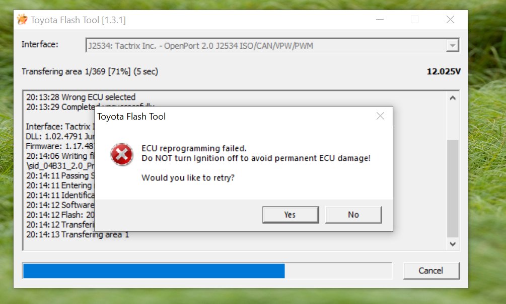

    It also failed on my first try.
    I downloaded then went out to flash and received the following error.
    I purged local data, then re-installed all software then re-installed the drivers then updated again.
    Then had to add the drivers and FM.exe to the white list in the antivirus again.
    After that I closed the FM and went through the flash process again.
    Loving the new beta.
    It says wrong ecu selected in the logs even though it wasn't that was something I did before the initial flash. I was looking into something else and cancelled out of the menu.

    Mat if you are interested here are the logs from the FM for the failed and sucessful.
    Interface: Tactrix Inc. - OpenPort 2.0 J2534 ISO/CAN/VPW/PWM
    DLL: 1.02.4791 Jun 2 2016 12:43:17
    Firmware: 1.17.4877
    20:14:06 Writing file: C:\Users\Scott\Documents\OV_TUNE\Beta Tunes\04B31 2019 AT\Prem\sid_04B31_2.0_Prem_Beta.p5f
    20:14:11 Passing Security Checks
    20:14:11 Entering reprogramming mode
    20:14:11 Identification
    20:14:12 Software: 89663-04B31
    20:14:12 Flash: 2048KB
    20:14:12 Transfering data
    20:14:13 Transfering area 1
    20:15:47 Completion
    20:15:47 Completed unsuccessfully
    Firmware: 1.17.4877
    Firmware: 1.17.4877
    20:16:11 Writing file: C:\Users\Scott\Documents\OV_TUNE\Beta Tunes\04B31 2019 AT\Prem\sid_04B31_2.0_Prem_Beta.p5f
    20:16:14 Passing Security Checks
    20:16:19 Entering reprogramming mode
    20:16:20 Identification
    20:16:20 Flash: 2048KB
    20:16:20 Transfering data
    20:16:21 Transfering area 1
    20:17:27 Validation
    20:17:28 Completion
    20:17:28 Completed successfully
    Then I reset the LV and AT.
    The only thing that has been a little wonky so far is the auto high beams. They seem very sensitive now and go to LB when driving by signs and house lights where they never did before. I doubt it was tune related, but maybe due to the LV or AT reset somehow. Not a game changer it just makes me look like I can't decide if I want the low or high beams on. I didn't get a change to test the radar cruise control yet, the regular CC worked without issue. Everything else has been great.
    Thanks for the new beta, it's like a new truck again.
