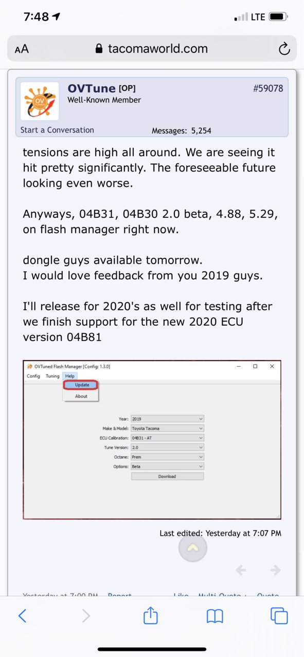

    Even though the PCFlash utility indicates ECU calibration 04B04 the dropdown in Flashmanager shows 04B02. How does this get updated?

    what?
    pix would be beneficial

    Select year : 2017
