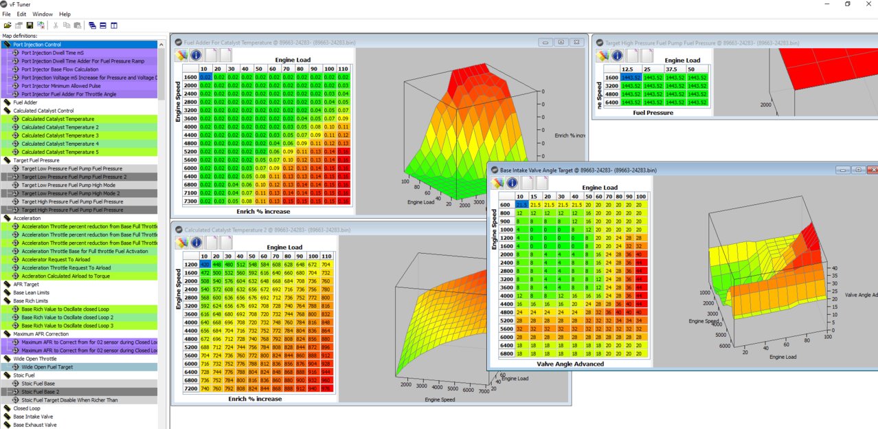

    vF Tuner is complete, version 1.0.0.8 is available.
    Anyone with our flash kits, can purchase a license for vF Tuner, unlock your ECU, for your own access and tuning.
    3.5L Tacoma support expected > Early April.
    You can flash, tune, datalog, etc.
    you can unlock more IDs via ID credits if you want to tune more trucks.

    Bilstein 5100/888; 5160/AAL; SCS Ray10 Limited Gold; 285/70 Cooper STT PRO; AVS; OVTuned; Prinsu Cabrac; RCI Bedrack; TC Bed Stiffner
    Everyone is a tuner until they melt their pistons. Lol

    2019 Tacoma TRD Off- road
    Price? And does it allow throttle adjustment/fine tuning? Only thing I see worth changing for the 2.0 beta for 2019s I just tried!
