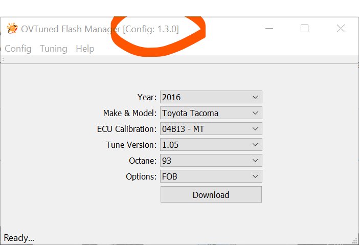

    The tune he wants is on Flash Manager but he has an older version of FM installed. He needs to get FM version 1.3.0, Nov 2019, remove the old version, install 1.3.0 and update.

    Thank you for the help. I got it done. It was my fault and stupidity that I did not know that I was not running the latest software. Once again, thank you.

    No worries. It's a bit confusing with multiple versions, the latest version being a lower value. Usually someone on here that can point folks in the right direction. :cheers:

    The config version is the number of times OVTune has pushed out a tune patch.
    The software version is the version need to look out for.
    So if you are on software version 1.3.0, the config version will reset back to 1.0.0.
    Since there should have been only one or two tune patches sent out, so it would be something like config version ex.(1.2.0)
    If Final 2.0 for everyone is sent out it could become config ver. 1.3.0

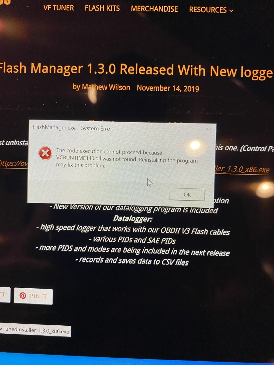

    Just received my flash kit and when I install it and try to run it I get this error. Read this and followed your link to the new version and same error. Sorry if this is a dumb question but what am I doing wrong here?F0975989-C963-4874-BB0E-7449A96D3846.jpg

    Check out the FAQ on the website. This is addressed.

    you didn't do anything wrong, hundreds of us have had the issue. You'll need an additional piece of software (from Microsoft).
    https://www.microsoft.com/en-us/download/details.aspx?id=52685

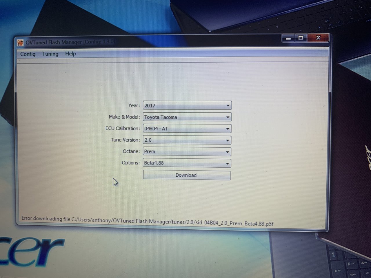

    Is 2.0 available for all years? Am I doing something wrong here?

    No and no.
    The 2.0 beta tune destined for 2019 AT appears now to be showing up for the other yrs as well. However you will get an error if you attempt to download it.
    This might indicate some further progress on FM. Don’t know. (Placeholder?)

    Gotcha I must’ve got mixed up somewhere in the thread. I though Mat released the files.

    Beta 2.0 is out for your truck, but you have to download it from Mat's website

    only the beta is out so far, not sure if there's a newer ver. - https://www.ovtuned.com/pages/2-0-public

    That's not the newest Beta though, it is the old BETA isn't it? Look at the published date, it is from October 2019
