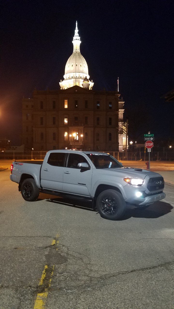

    went out last night for a drive, with the new 2.0 beta (premium fuel) for the 2019's (running 90+ octane non eth fuel). mixed usage of country roads, 45-60 mph, city driving, 25-45mph, and a few short highway sections, 70-80mph. the truck is still in learning mode, as i reset the LV, and AT values, for the flash. i am noticing the lag in the pedal down low from a stop, a bit. not terrible, not annoying, i just know it is there, and not telepathic down low. it is like a slight lag in the TPS, to pedal interface.
    3rd-4th gear quick shift is GONE (THANK YOU MAT), holds 5-6th longer and seems to just unlock the torque converter v.s grabbing a gear on most hills (other than Smode, I wish there was an auto way to lock out 5-6th below 50 mph, then once above 50 the trans would be allowed to shift up a gear to fifth. and after 60-65, the truck would be allowed into 6th).
    the big punch from 3500 rpms up is GONE, it is smooth, linear, and very nice. rolling full throttle blasts are nice, no rev limter, cut out, or shift delay, so far. i did watch the rpms and it seems it is set to shift at at full throttle around 6000 rpm, gear to gear. i thought the shift rpms would be closer to 7000 with the updates but, i could be wrong, and the truck could still be learning.
    all in all, i am very happy with the new tune, I havent had any warnings, overrides etc... but, again i only went out for about 65 miles or so, and the lv and at values are learning me, as much as i am learning to drive it, with the new tune. i will keep updating the thread as i drive the truck more.
    thank you Mat, wishing you and your family, crew, health and well being in these uncertain times. thank you for keeping on with the development of this tune, and the quirks in the 19-20 M.Y. trucks. it is APPRECIATED! Ski

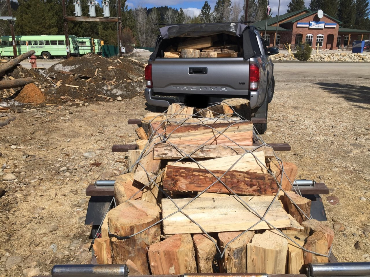

    Hey Brew,
    I flashed the 04B04 2.0 beta in the 91 octane 4.88 version a few days ago. Today I drove 65 miles up and down a mountain highway today to get wood. The tune drove very nice and I got a combined 18.5mph. The final should be cherry. Truck drives and holds gears so nicely with 4.88’s even with 1,600lbs of wood give it take. 255/75/17’s
