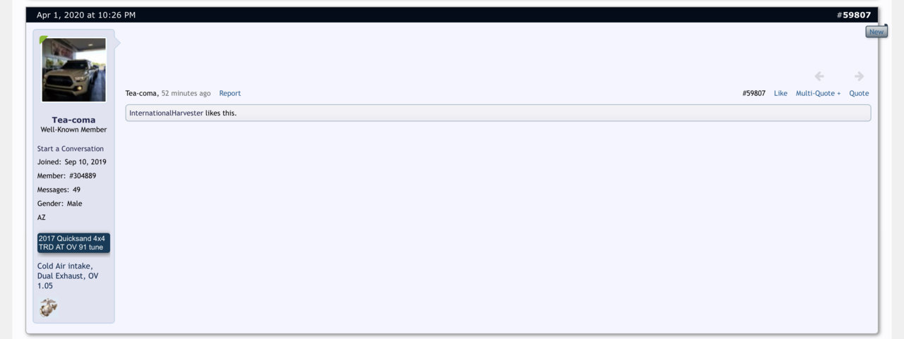

    Best post ever
    Edit: oh snap, I thought it was just a blank post with nothing said. I guess there’s a picture there that I can’t see.

    All I see is a blank post

    lol, after you said "best post ever", I was trying to figure out how to see/download the image.
    nothing to see here, carry on
