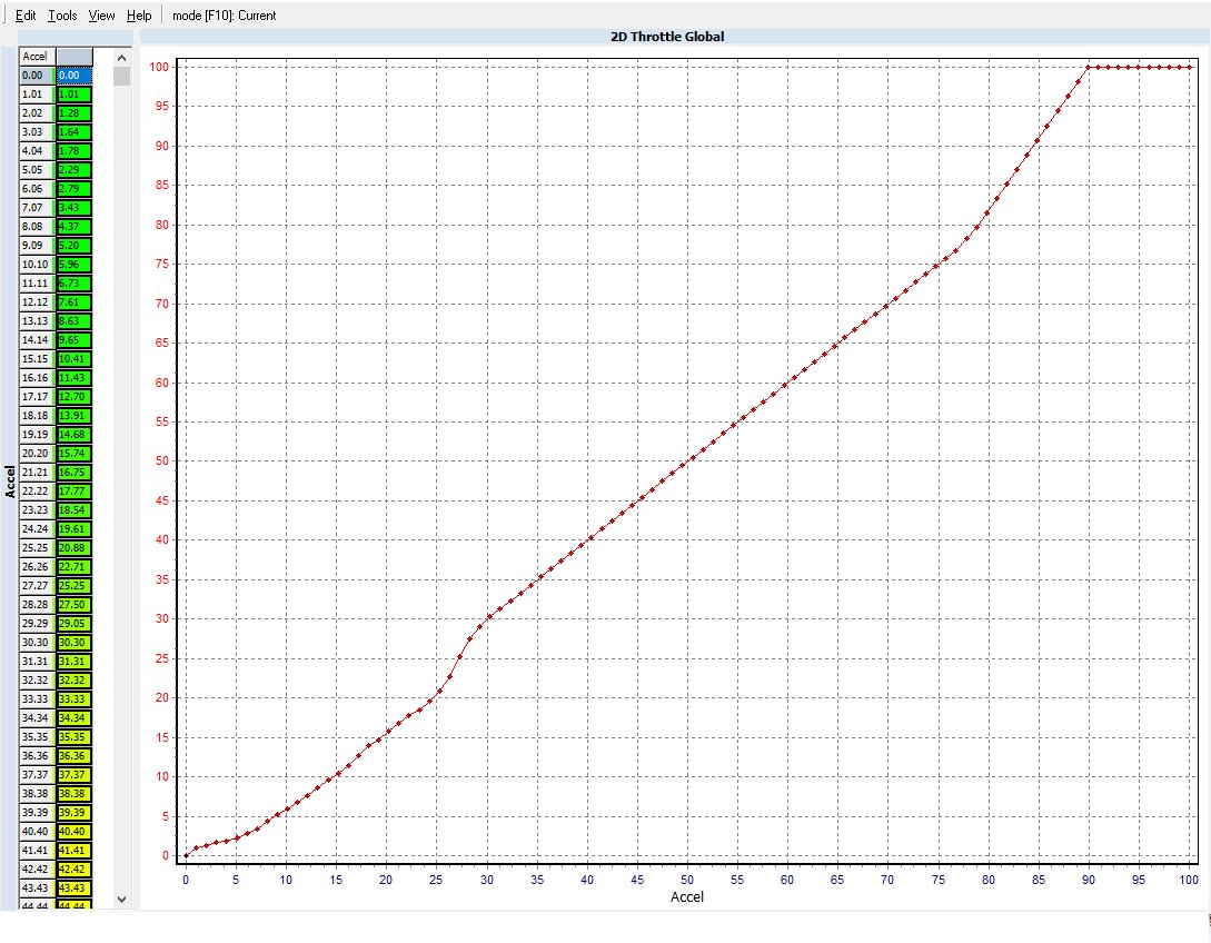

    I honestly feel bad about giving my experience with it because of recent trolling on here and the high stress that everyone is going through right now. But, my pedal feels dead, like it doesn’t do anything until it goes about an inch or more and then all the power hits. It does this at every speed And in every gear. It’s really hard for me to manage it. My head is constantly being slightly thrown back all day driving because the power hits at such a strange place.
    Other than that, this tune is perfect. I have been one of the guys in the past that has said the 2.0 Beta has no felt increase in power or shifting from stick with a 2019.
    This new Beta is completely different and I can very much feel the better power, torque, and shifting. The way this tune feels is why I purchased the tune in the first place.

    19800 tip-in is perfect

    I thought the tip in talk was a thing of the past. Push it 5% to the floor and get 5%, push it 50, get 50. At least close to that anyway.
    that at least makes sense, why people want all the throttle in the first inch of pedal is strange, there’s space between the pedal and the floor for a reason.

    that table setup will be in 2.0 final...but the linear style is too sensitive.
    Finding the right balance for throttle response....ugh
    G8R_Taco, perkj and FCL30 like this.

    Is this User-adjustable with Vf?

    yes it will be

    Me too, 19800 is perfect. Matches the tip in of my 17 4Runner.

    sounds to me like you should adjust it to your liking, anyone that doesn’t like it can adjust it via vf flash and call it a day.

    Just to clarify the tip-in. I think I know how to describe it better. Each number percent below will be at a 1mm increment as youre pushing the pedal.
    1%, 1%, 1%, 2%, 2%, 2%, 3%, 3%, 3%, and then it hits 15% all of a sudden and it’s a kick of throttle.
    My feedback is not that its too little or too much of a tip-in, it’s the wall it hits all of a sudden any time you move the pedal to that certain point.
    There is just no gradual incline or ramp up. It’s nothing for a while, then it hits.
    I’m only giving this feedback so that IF you want to change it, you have an idea of what’s going on exactly. Otherwise we can just fix it ourselves with vF. No problem with that either.

    I have to agree with the others on the tip in, it was a lot better in 19800 beta. Other than that, excellent work. Thanks Mat! Stay safe
