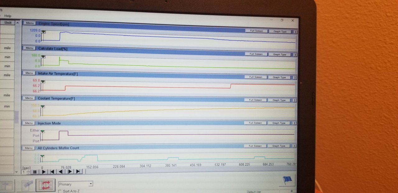

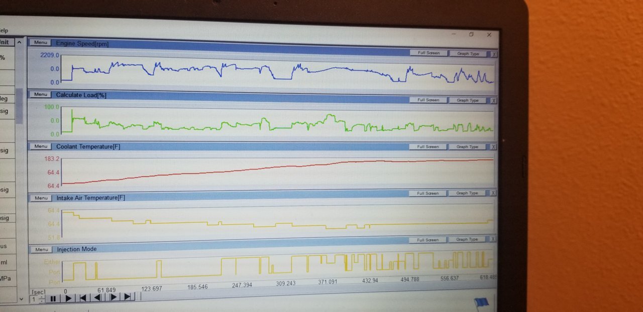

    Ok. Here is idling sample. Bottom graph on idling sample is for @Shellshock
    Also added catalog sample from your vvt modifief 2.0 beta

    OVTune
    Can you clarify, what tune are these pictures from.

    2017 White SR5 DCSB V6 4x4
    Your tunes.
    One with a flat line 2.0 87 base file posted yesterday.
    The other for comparison reasons is for ticket 12710 from February 2020

    OVTune
    Great, looks like start up is functioning as it should.
    Seriously, direct mode from startup to shutdown(based on previous logs).
    When our valves gonna get cleaned? What Am I missing?
    Ok, I'll take her a spin to get more data.

    2019 Tacoma SR5 4x4
    looking at your table of the new tune, it looks like it's in port then either for about a minute and a half at startup. So, i'd guess that's when it will clean.
    It is not. It is only for 25 sec. See RPMs graph
