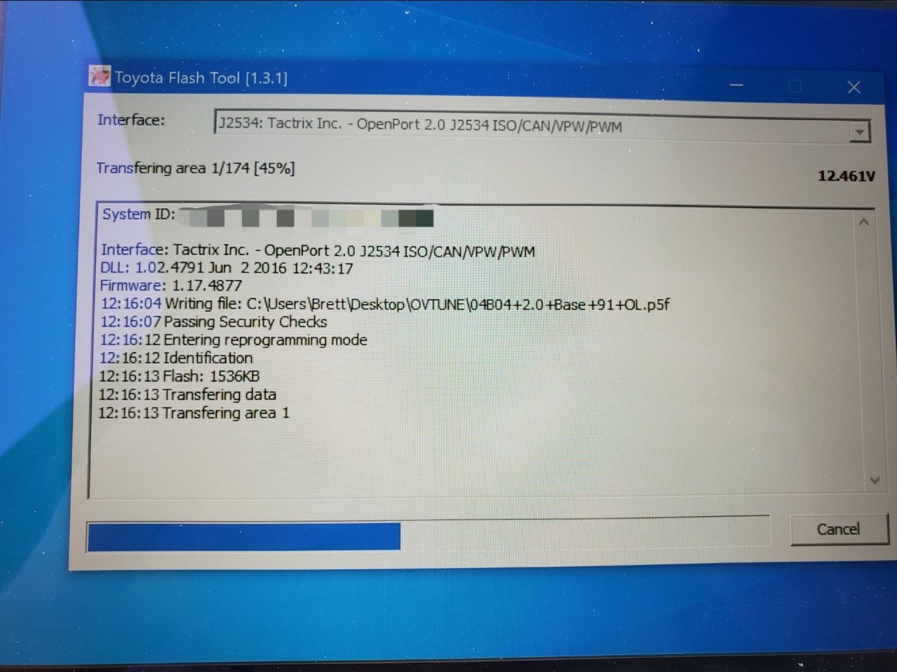

    This was likely mentioned but if you get "Completed unsuccessfully" when trying to flash. It is safe to ignore it and flash anyway. I had to do it a few times and then it went right on through. Freaked me out for a minute there. Defender turned off, OBDII selected to my Virtual Machine and all. Luckily just opening and clicking flash was totally fine. Also managed to reset AT and LV that way.
    Going to have to get some miles on it now. It was not happy starting up after all that! Haha. It actually nearly failed to start up then idle was all over the board but appears to be normal until it settles down.
    I'll take it for a spin later today or tomorrow and should see improvements. Looking forward to the 3/4 fix mostly. Otherwise been quite happy with the beta .
    Curious why it does this though. It identified each time with the betas and no changes to my VM that I know of. Shrug.
