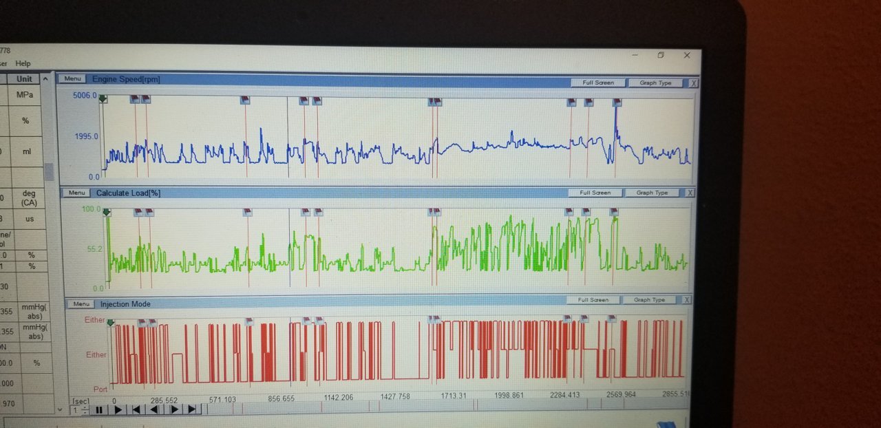

    Coud you ,as the subject matter expert, explain how are you going to clean intake valve carbon build up if you dont run port injection?
    What you are saying as far as cleaning is applicable to the di injectors, not valves
    I drove 40 minutes in direct mode, what will happen to those valves after 15, 30, 60K miles?
    WHTLTNG and Scralatchtica824 like this.

    OVTune
    OVTune [OP] Well-Known Member
    Mar 27, 2017
    #214557
    8,112
    OVTune
    Port injection is used when you start the truck and used even more when the engine is cold.
    it is also used at moderate temp depending on engine RPM and load.
    unless you never, ever shut your truck off, port injection is still going to be used.
    The port injection does not have to be used as much as OEM in order to keep the intake valves clean.
  5. Apr 20, 2020 at 1:12 PM
    Vlady
    Vlady Well-Known Member
    Dec 20, 2017
    #238986
    4,507
    Issy, WA
    2017 White SR5 DCSB V6 4x4
    Here is September 2019 2.0 beta 19800.
    Middle steps is Direct mode.
    Count how many seconds the engine was In Direct mode.

  7. Apr 20, 2020 at 1:14 PM
    OVTune
    Mar 27, 2017
    #214557
    8,112
    OVTune
    Okay, you are welcome to tune the injection mode however you wish with vF Tuner.
    There are pros and cons to various ways of injection control.
    The older betas did not include this. That doesn't mean that the older betas version is "better."

    Just to be 100% clear here, you are certain that the truck still runs in port injection mode enough to clean deposits off of the valves? If so, this whole conversation is moot.

    The issue is not which injection is better. Issue is will I need to scrub my valves in a year or so.
    WHTLTNG likes this.

    OVTune
    Mar 27, 2017
    #214557
    8,112
    OVTune
    On the current setup the port injection will still be used, in port only or combined state, when the engine is cold. That's every time you start up.
    Port injection is used every time during cranking, regardless of engine temp. So every time you start the valves are sprayed.
    Port injection is still used during cat warm up mode.
    So at a minimum you should still see port injection spray activity for anywhere from 15 seconds to a few minutes, depending on engine temp.
    that is before ECU calculated injection cleaning cycles.
    If the port injection was never used ever, I think you would have a more valid concern.

  15. Apr 20, 2020 at 1:30 PM
    Vlady
    Dec 20, 2017
    #238986
    4,507
    Issy, WA
    I showed you a sample where it squirted once and you are saying this is normal?
    Alright..

  17. Apr 20, 2020 at 1:37 PM
    OVTune
    Mar 27, 2017
    #214557
    8,112
    OVTune
    it is working as I designed it.
    Can you please provide me with the data of how much time is required per drive cycle to ensure your valves are clean?
    MOC221_, thedriza, Rainoffire and 6 others like this.

    Can we get another user or two to monitor DI and PI on this new release of 2.0? More data points are needed.

  20. Apr 20, 2020 at 1:38 PM
    Big geek
    Big geek Well-Known Member
    Apr 6, 2017
    #215573
    71
    Your sample did not include, startup, low coolant temp, low catalyst temp. So, yes, that is normal. Do you wash your truck continually or once a week? Pretty sure he has better insight than you and if you don’t like it, get vF tune. Can’t wait for my dongle trade to be done so I can abandon this thread.
